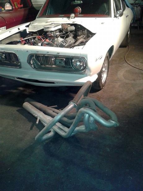

Got em on my Duster, like em a lot. As far as the collectors go just get a couple of large hose clamps and pull em together then start the collector on.
Only problem I really had with them is on #4 (I think) with straight plug heads, the spark plug is real close to the tube. Kept burning plug boots till I went to Rajah clips on it.
We are mocking up a set of his 2-1/8 headers on a 73 Scamp with a 440/493 conversion, we are using the A/R engine plate, initial mockup was ok, may need a little massaging of the tubes, we definitely had to open up the fenders larger than the templates given. We will be setting motor in again over the next week or so, our motor is also using the raised port Edelbrock Victor 440 max wedge heads which pose more issues ! I'll try to post some pics..
