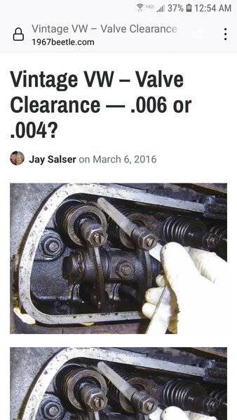

Jun 25, 2022 #51 George Jets 1967 Dart 2 Door FABO Gold Member Joined Jan 18, 2019 Messages 11,586 Reaction score 16,385 Location Palm Bay FL Stock VW 1600 cc engines valve lash is set at .004 - .006 ths. Aluminum Heads, solid lifters and adjustable rockers.
