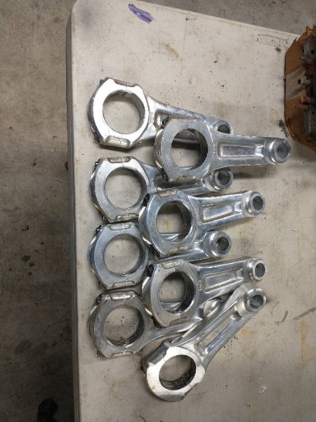

“I got a good set of Bill Miller aluminum 426 rods standard length 20 passes on them” (His picture of all 8).

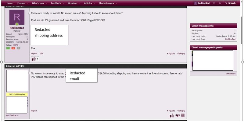

In PM I asked and he replied:
HE FLAT OUT LIED!

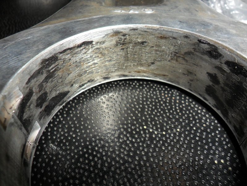

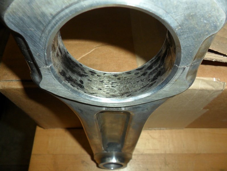

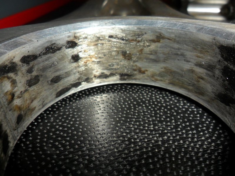

Turns out that 7 out of 8 rods are SEVERLY SCORED on the crank bore. If I had to guess, the owner lost oil pressure and spun a bunch of bearings. At any rate, they are NOT ready to use and seller knows he would still have them had he FULLY DISCLOSED the true condition of the rods.
Maybe they can be reconditioned…..$300 obo

I don't like the looks of those rods but I have seen those patterns before on steel rods. @RedlineRed , you do need to take them to a machine shop for a look see. Contact @badlilred79 for a refund. You may loose out on some shipping.

My primary concern with those wouldn't be needing to have them resized, but work hardening from the excess heat. I would email pictures to BME and get their opinion. BME has a good write up on the superior ALCOA spec'd alloy, but aluminum is notoriously fickle when subjected to extremes in temperature and vibration. That's very similar to the kind of damage seen in an over revved nostalgia class fuel engine.
Thank you. Already did but have not heard back yet.
Did the original ad show a closer angle of the crank ends of the rods? Seems like you'd almost have to try to hide that.
No. You can go back to the original add (if it is still there) and see all his pics. You can barely make out a possible issue only if you look really close. But again, I specifically asked in a PM and was told no issues, ready to use.
