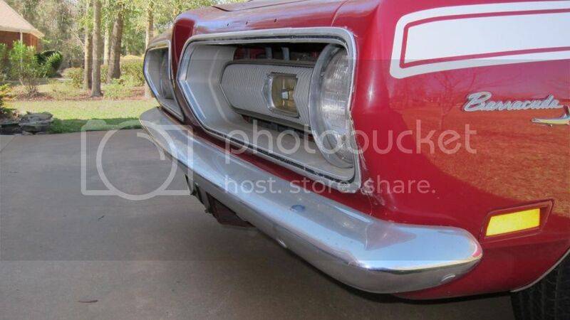

So right off the bat, there's something fishy about the sheetmetal/bodywork story. '69 front end modded to accept '68 grilles or a '68 front end with a nose-job? Either way, it's all wrong up front and a sure sign of a frontal impact.

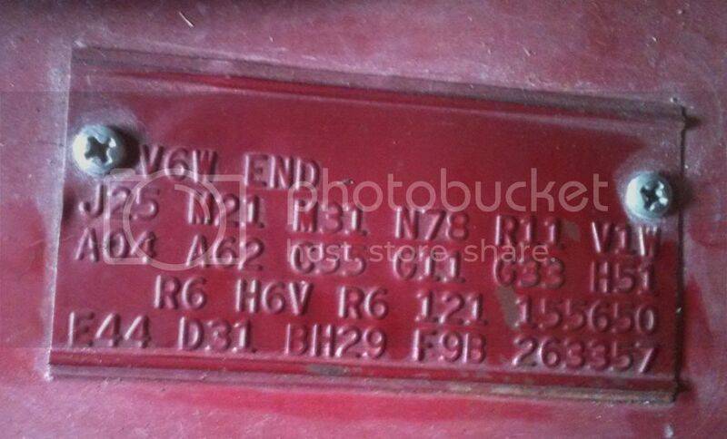

So what else do we have here? Basically, the car was originally Scorch Red with white side stripes, white interior, white vinyl top (did Plymouth do this?) factory air, performance indicator, 318 cubic inch V8, and 3-speed automatic with column shift. Oh yeah, and a fender tag that backs it all up.
Right about now, I google and find For A-Bodies Only. I post a thread seeking some info about what this car might be worth and it would be the last time I ever do that ;) Along the way I discover the "Slickback", the factory-installed vinyl roof treatment that was only offered on fastbacks in 1969. Hmmm, very cool!

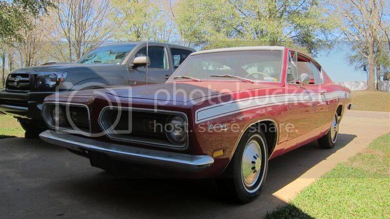

The day I got her home:
Ugh...where to start.
Love it, It looks really straight for original paint, bumper are nice and the grilles (68 ) are in real good condition. Head rests! and looks like a wood grain wheel. It does look like it was garaged and well cared for.
please take the duster hubcaps off and find them another home! lol

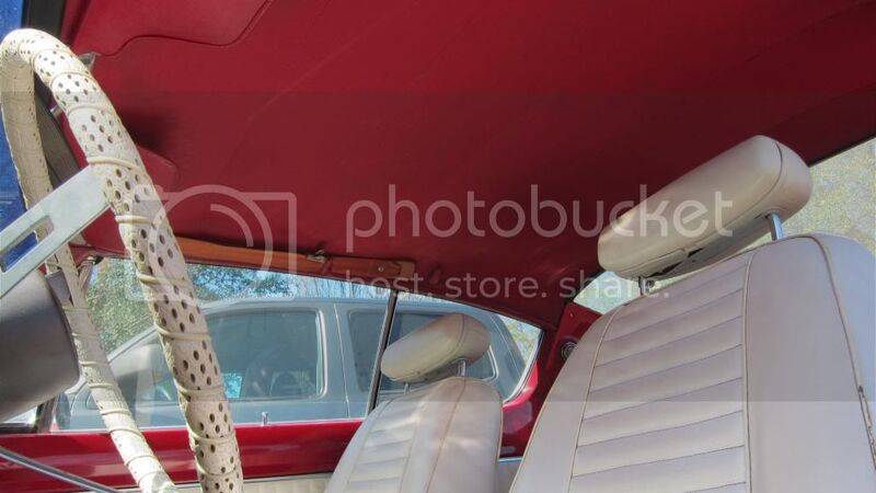

Just a few stains on the ceiling but proper mold control mandates the removal and replacement of all "soft tissue" that cannot be thoroughly cleaned. I suspect the headliner will disintegrate as soon as I touch it.

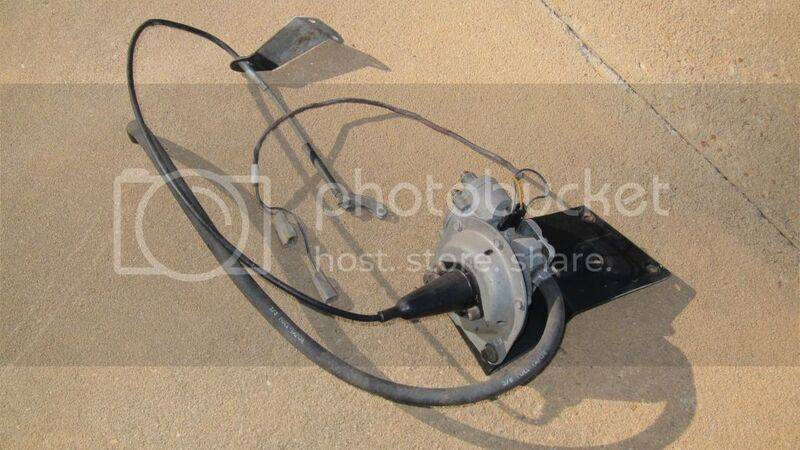

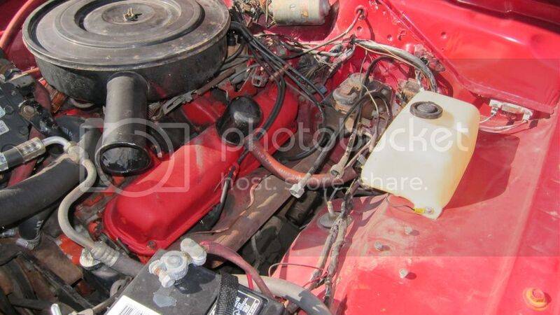

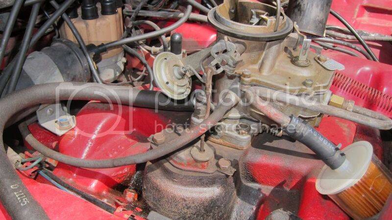

And what is probably the original 318. Note the cruise control unit on the fender.

The engine idles well and there is no longer any smoke at the tailpipe. Not concerned with ignition right now so fueling has got to be tended to. Three-year-old gasoline sitting stale cannot be good for the carb which I know has a stuck accelerator pump so, let's get that off of there and give it a full rebuild.
Here's the carb before removal. Ditto the cruise control main unit. With the cruise gone, there'll be one less potential vacuum fault.
Cruise control gone.

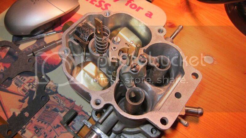

Another look at the carb before undergoing surgery.
The level of detail that went into the carburetor got a little stupid. Maybe it was 25 years in the Army but I saw brass and just had to polish it.

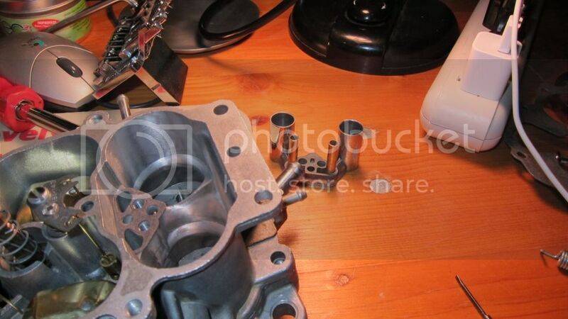

After polishing the floats so nice that my drill sergeant from '86 would have approved, I looked at the venturis inside the carb and found some casting seams and a sort of textured finish that could be smoothed-out. Its the sort of thing I would have done on my VW that I tinker with incessantly so, why not do it here?
So here's the carb going back together with shiny floats and polished barrels.
At this point, I realized that the venturi cluster really looked like crap so I took that back out and started polishing it up as well. Took a moment to snap a picture while working on the second venturi...

Subscribed. Very nice Cuda! What's the deal with the cruise control? Aftermarket?
I suspect so. No indication that cruise was ever available on the cuda in '69 though it was on other models. Could be a factory setup swapped in from a B-body or straight up aftermarket but I do not know.

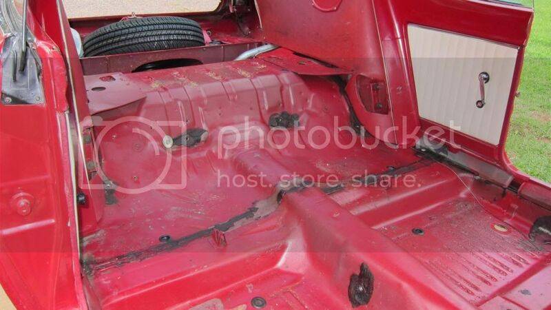

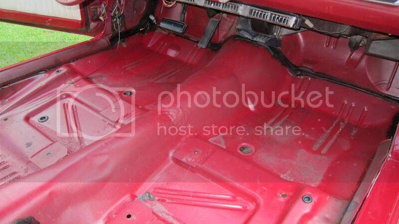

The seats, kick panels, sill plates, seatbelts, and carpet all came outwithout a hitch revealing some very solid floors.

Got all the seating pulled up, time to get the cargo floor out so we can scrub the floor real good.
With that done, I got the car up on ramps and pulled out some body plugs from the floor so I could go at it with a scrub brush, some Dawn soap, and a helluva lotta water. Pulling the plugs will allow for good drainage making it easy to get the car dried-out quickly. Don't wanna damage those floors!
In this next pic, you can see that some of the black waxy seam sealant was coming off. I'll ultimately take it all out and put something else in its place.
Also did the trunk area, the spare, the jack, and started pulling the old, dry-rotted trunk seal (note replacement sitting on spare)
