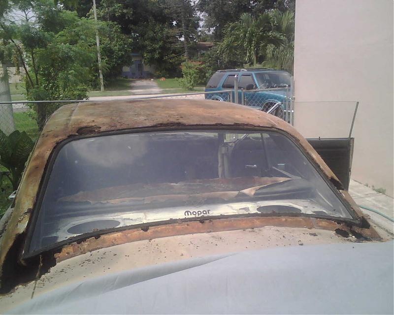

what year dart can i use to repair the damage, pic below i currently have a 1970 swinger it will need the entire rear panel around the window edge. thanks any help would be great.
I think any 70-76 2door Dart or Scamp will fit. Since you need at least the roof and trunk filler panel, your best is to find a parts car that has rotten bottom. They are cheap since most people are usually looking for no rust on the bottom. :)
Grant
Wow! Is the rest of the car worth saving? I would look for another car if it isn't. Good luck.
The roof from any 2 dr hardtop A body from '67 to '76 should work.
thats why i do not like vinyl tops sad. B4 i did any thing else to it I would gut it and check the floors when the water came in it went somewhere
