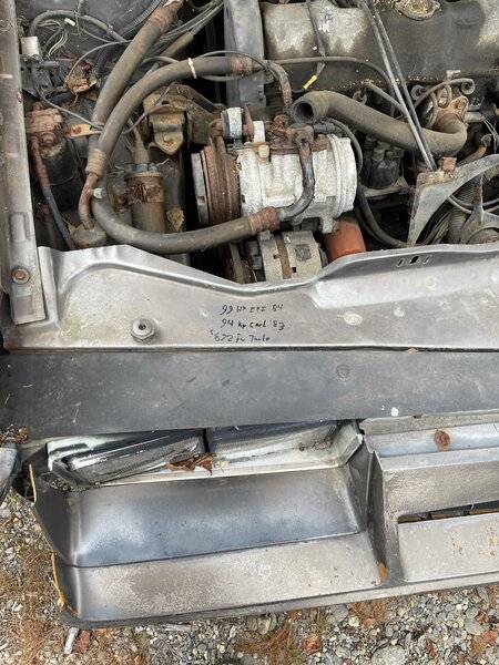

We did find his sharpie notes written on a few of the vehicles which was cool to see.
This was on the Chrysler Laser I believe…
