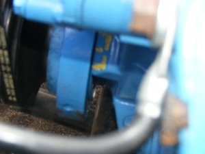

Here is what my 360 balancer looked like with the rubber ring having worked it,s way out.Hope this helps!re and re of 66 Dart 017.jpgAnd the new one
