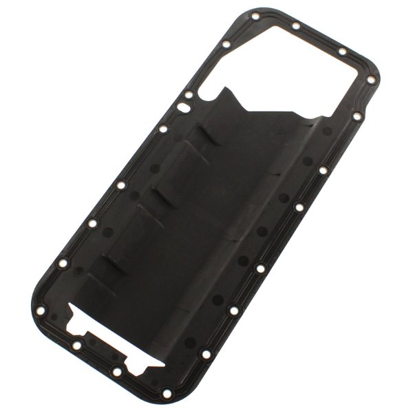

adding studs to the pan rail makes things much easier, at least on the 4 corners.
Online says a guy can cut for the rear sump and it will work just like the Mr Gasket (which advertises that it services both).
Re-usable?
you just sold me. I was going to buy 2 fel pro pan gaskets at 18.00 each. This seems like a cost savings in just one removal from assembly. Also, online reviews are good. Thanks
