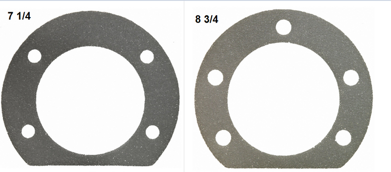

okay, so full caveat that i don't have it sitting right here in front of me... but, i don't think it will work because the diameter of the hole on retainer plate.
the 7.25 axle bolts in and the "flange" retains the bearing and axle together. i *think* the hole on the brake kit retainer is too big and the bearing would just slip right thru.
beyond that, *if* it would work, you'd need to press the bearings off the axles and install new. as well as double check the thickness of the plate-- although there's probably enough take up in the brakes there to account for the 1/16~1/8 that it'd be different. i think. maybe.
7 1/4 bearing OD is 2.74"
8 3/4 bearing OD is 2.92"

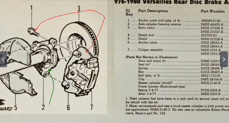

Don't know which calipers they are but they work the same a 76-80's Mercury Versailles. One thing I remember is having to remove the e brake lever to turn the piston in at pad change. then realign the lever to the shaft and then put the pad in.
I bought the calipers and the mount and the other hardware ( red arrows) and made from a drum backing plate and some strap steel, the bracket that mounts to the axle housing green arrow. the stock mount would not place the caliper in the right spot. they worked flawlessly
