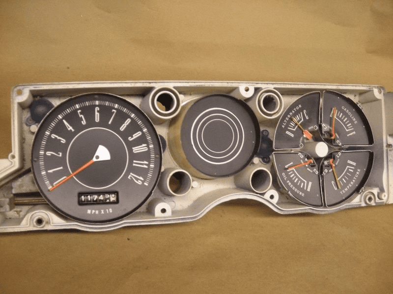

Ok, here's what I suggest to help brightness. See the attachment for reference as this applies to rallye gauges but should also work for any cluster.
1. See those blue diffusers? Take them out and clean them very well. the dirt that collects in them over the past 50 plus years blocks light. Also, the old plastic gets cloudy with age and also blocks light.
2. Make sure when you put the blue diffusers back, they are sealed up tightly so they don't " leak" light.
3. Paint the whole inside of the housing bright white to increase reflectiveness
4. As was suggested by 65TerrorCuda, replace all the bulbs with Leds . they will last way longer than incandescent bulbs and are brighter.
5. Clean the gauge faces and the white markings on them.
6. Polish the clear lenses.

I will definitely try the LED's.. I recently had my cluster completely torn down and cleaned everything, as well as sand, buff and polished the lenses. I even painted the needles.
I didn't, however, repaint the housing as it looked pretty good..

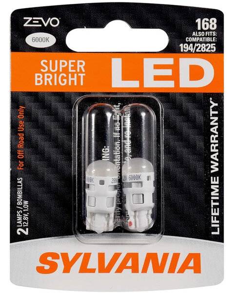

I went with these bulbs and they are dimmable with the knob. They are pricy but I’m hoping Sylvania is a cut above the no name LEDs on amazon. I only replaced the gauge lighting not things like turn signals, high beam indicator, oil and brake light

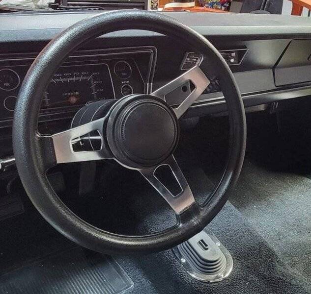

Simple test if you're concerned about instrument panel light intensity...like I am! My 71 Demon is darn near impossible to see the gauges at night. So since we know the dash lights are fed from the rheostat on the headlight switch (rheostat feeds the instrument panel fuse in the fusebix), we can bypass the rheostat by a simple alligator clip jumper wire feeding the fuse with a straight 12v.
Pick another fuse that has 12v on it and clip to it then clip the other end to your instrument panel fuse. That bypasses the rheostat and makes your dash lights as bright as they're gonna be since full voltage is applied. It also tells you if you need a new headlight switch if the dash lights are brighter than they were when being fed thru the headlight switch.
In my case, I need a new headlight switch but even with the 12v applied as noted above, I've decided that the gauges are not bright enough for me. So I'm in the process of replacing the 194 dash bulbs with LEDs. I got the new headlight switch at O'Reilly's and the LEDs have been ordered online at Superbrightleds.com.
