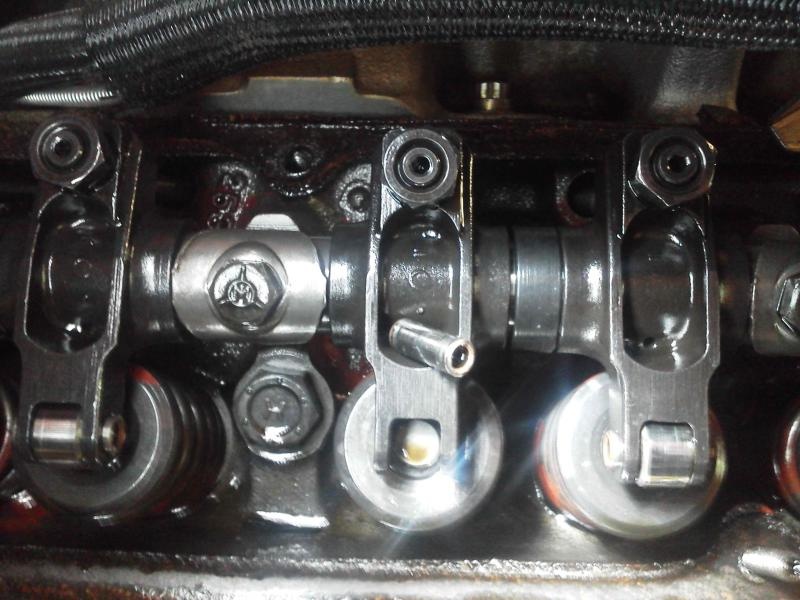

heres a picture of the piece in question, please let me know how someone like I should go about fixing this, Im assuming I take entire rocker arm assembly off and carry it to napa and have them order right parts? (the brass piece was what used to hold the little pin to the rocker arm, didnt look very hard for it but didnt see it in open)
Pull the pushrod out and roll it on a flat surface. You can tell if its bent.Where is the roller for the rocker arm? Check the top of the valve stem carefully that it isnt beat up. Still dont understand about the brass piece. I thought those roller pins were press fit and peaned once in. I myself would buy a good set of rockers that arent going to fall apart. You narrowly missed a catastrophe. I broke a rocker, the lifter jumped out of the hole into the valley and the cam grabbed the push rod and wound it thru the block to the oil pan ruining the lifter bore breaking a piston skirt and cracking the cylinder wall.Count your blessings and buy good parts.
I am guessing by looking at the pin on the other rockers they look like they are held on by some brass colored piece that goes through the center of it. I have no clue how they are held together. The roller for the rocker arm I set ontop of rockerarm for picture so people could see the part that broke off.
The piece laying on top is the pin that runs thru the roller. The roller itself is not shown. Also if that pin snapped there could be a piece of it somewhere also.............Im searching right now to try and find that brand of rocker......be back later.
upon closer inspection, the piece laying on arm in picture in the center part of the roller pin, the outside part that rides on spring was ontop of head also! Will replace push-rod and rocker-arm then fire her up and hope I didnt bend a valve since I was under 5k rpms when this happened. And there is NO brass anything dont know what I was seeing, maybe shinny metal covering in golden brown oil making me think it was brass

From what i can find those rockers are either a early style Compcams Magnum (no longer available i believe) or a chinese knock off, also may be hard to find. I don't believe they are bronze bushed either.

Summit's photo is generic.....here is what they should actually look like..
http://www.cnc-motorsports.com/comp-cams-1622-16-ultra-pro-magnum-chrysler-shaft-rocker-arms.html/
I suppose you could try to substitute 1 of them if you could get the spacing correct so the roller is centered on the valve tip.
