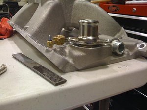

I'm trying to find a bypass hose, but can't find one that fits. I've tried the regular one and looked for something that would fit, but haven't found anything.
It's an LA 360 block with Magnum heads and Airgap intake (Magnum). Normally, the bypass hose connects to the intake right by the thermostat housing, but on this intake, it's toward the driver side. Tried using a regular piece of hose, but it just kinks.
I'm sure I'm not the first to run into this problem. What's the solution?

Just got a thought. Could I run a hose from the heater hose outlet on the water pump to the bypass inlet on the intake and cap off the bypass? It would still be getting that bypass coolant, just not as much. All I need is a 3/4" NPT fitting with a 5/8 "nipple, which I have found, and a piece of 5/8" hose with a 90 degree bend, which I have also found. I also have an NPT plug that's just the right size to plug the bypass outlet on the water pump. Sounds like a lot, but I think it's easier than trying to find a 1" hose with the right bend and twist to reach from the bypass.

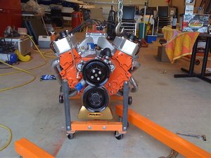

I have a M1 Single Plane Intake on mine and the nipple that comes off the intake is EXACTLY where yours is. I used the stock hose on mine and I run a heater core so I used all the connections. It does look like you used a LONGER nipple on the intake than I did but you could possibly still get the hose on it.
Here is a picture of my Intake etc. I originally went to NAPA because I thought the hose wouldnt work but I was wrong.

It does look like it's in the same place, but set back about 1/2" and with a shorter nipple. It might work with a shorter nipple, but it definitely does not with this long one. I think they even have the shorter nipples like yours at the Kragen down the street. I'll give it a shot. Thanks. BTW, have you had any troubles running stock pulleys? I used to throw belts like crazy on a torquey other-than-Mopar car I once had.
No it doesnt throw belts or anything. Just explodes Alternators and Dampers............haaaaaaaaaa
Try what Justin says, cut the hose or the nipple. That should fix the issue.
