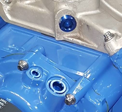

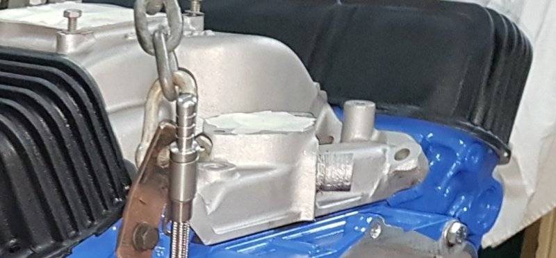

Can't say yet as it's not in the car yet, i plan to run a 10an hose from the manifold (not the one pictured) to radiator so i can run a thermostat and still bypass through the radiator, let you know how it go's.
