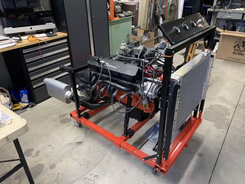

I am getting close to the break in time. I hope that I have all the boxes checked. The setup is not mopar factory stuff. The distributor is a "ready to run" that does not need a separate ignition module. The alternator is internally regulated and has a sense wire that goes to the starter relay. Coil is HEI hyperspark. The run stand has oil pressure, water temp and tachometer on the dash. Any other help, let me know
1. I have done the priming and will redo that before distributor install.
2. full battery, assembly lube, penn break in oil
3. Will set timing to 10* btdc before start up
4. Will get the fuel into carb and primed for start
5. timing light ready for 3500 set to 36* . then back down the rpm to 2000 for 20 minutes.
6. Transmission line connected together, fluid level will be monitored
7. shop fan ready to blow air on the radiator and water ready to carefully mist the radiator if need be.
8. Inner valve springs have been removed , valves adjusted.
9. The spark plug wires will be adjusted and placed in guides to keep them organized and prevent cross current
9. The spark plug wires will be adjusted and placed in guides to keep them organized and prevent cross currentView attachment 1715372444 View attachment 1715372445 View attachment 1715372446
