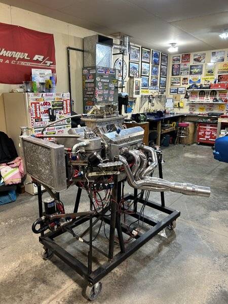

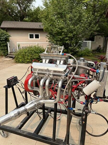

I built my run stand with scrap and some extra wheels/gauges I had laying around. Might have $60 in it. Also, if you use a belt it will need to be cogged or it WILL slip. There is no way a V-belt will hold the kind of tension it will require, at the gear ratio necessary, to spin an engine over. One more thing, nothing builds coolant pressure quickly, there isn’t enough restriction in a cooling system to build pressure at the flow level the pump is capable of with cold coolant. You’ll need heat and flow to build pressure.

Easy to build. Scrap materials and a welder. Only thing I had to buy was the castors. I’ve had several small blocks on my stand.
