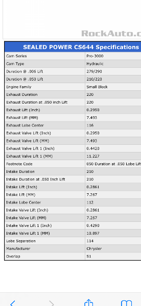

This cam came out of a rebuilt 340 . The only numbers/letters on it are - (CCS 644) . Numbers/letters are on the back side of the cam . We thought it was a Comp Cams , so we called . They said there would be some more numbers on it but , , there isn't . To that while still on the phone , Comp says it's not there's ? ? So , if anyone recognizes these numbers send us a message . Thanks and Merry Christmas . . .
This is what I got from Google, looks like a 340 replacement cam
Cam SeriesPro-3000
Cam TypeHydraulic
Duration @ .006 Lift279/290
Duration @ .050 Lift210/220
Engine FamilySmall Block
Exhaust Duration220
Exhaust Duration at .050 inch Lift220
Exhaust Lift (Inch)0.2950
Exhaust Lift (MM)7.493
Exhaust Lobe Center116
Exhaust Valve Lift (Inch)0.2950
Exhaust Valve Lift (MM)7.493
Exhaust Valve Lift 1 (Inch)0.4420
Exhaust Valve Lift 1 (MM)11.227
Footnote Code050 Duration at .050 Lobe Lift
Intake Duration210
Intake Duration at .050 Inch Lift210
Intake Lift (Inch)0.2861
Intake Lift (MM)7.267
Intake Lobe Center112
Intake Valve Lift (Inch)0.2861
Intake Valve Lift (MM)7.267
Intake Valve Lift 1 (Inch)0.4290
Intake Valve Lift 1 (MM)10.897
Lobe Separation114
ManufacturerChrysler
Overlap51
Cam SeriesPro-3000
Cam TypeHydraulic
Exhaust Duration220
Intake Duration210
Lobe Separation114
Overlap51

Thanks everyone for helping us with the specs on this cam . Have a Merry Christmas and Happy New Year . D.y
that good info i was just looking at one of those cam yesterday same cs644 number was wondering what the spec where
