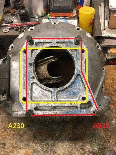

If the one being sold with the 833 will line up your existing clutch linkage, I don’t see why you couldn’t use it. Here is a pic of a bellhousing that came with my 833 OD. The bolts are in the holes that line up with an 833. You can see the other 4 holes for a different transmission. The holes in this bellhousing match exactly with a 340 bellhousing I have that came off of a 72 Duster 340 that I am 100% certain had an A230 trans.Hopefully after looking at this you can look at yours to see. Looking at this pic, the bottom left hole without a bolt in it is visible with the 833 bolted to the bellhousing.
Wow, you're the best. :thumbsup:
This time, I understood everything.
On my current belhousing, normally, I can easily see the two bottom holes provided for the A833 under my A230 gearbox body.
Thanks again very much for your help... :)

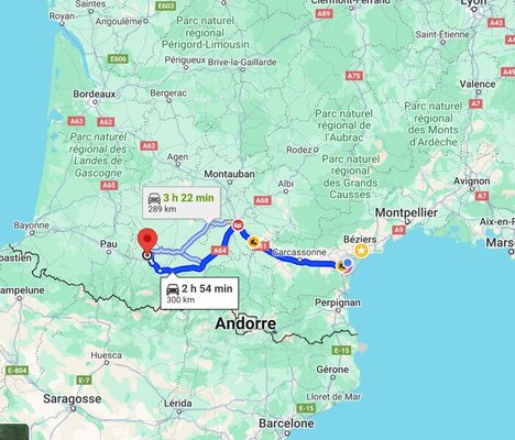

Just for the fun, here's the trip :
Ok, I found another solution : the gearbox and driveshaft will be delivered to me on friday by a transporter :thumbsup:
No more expensive than if I had made the road myself. And less fatigue

I also checked my current bellhousing and it doesn't have the dual pattern mounting holes :(
So, I will have to use the '66 bellhousing which comes with the 833.

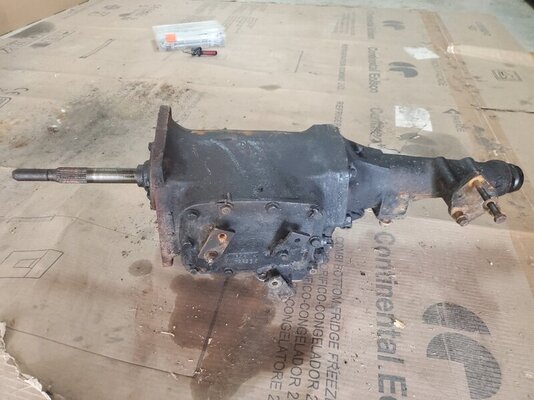

The gearbox and loose parts are arrived home this evening.

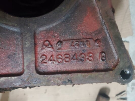

It's night here now, and I just took apart the bellhousing to check the part#. 2468433
Tomorrow, I will continue to disassemble the exterior parts : the shifter and rods, the speedometer cable and the crossmember.
Mine is a '66 one, with a slip-yoke tailshaft.
This morning, I stripped it.
No leak, the 3 gear levers move freely forward and rearward
Next step : degreasing the gearbox and external parts.
