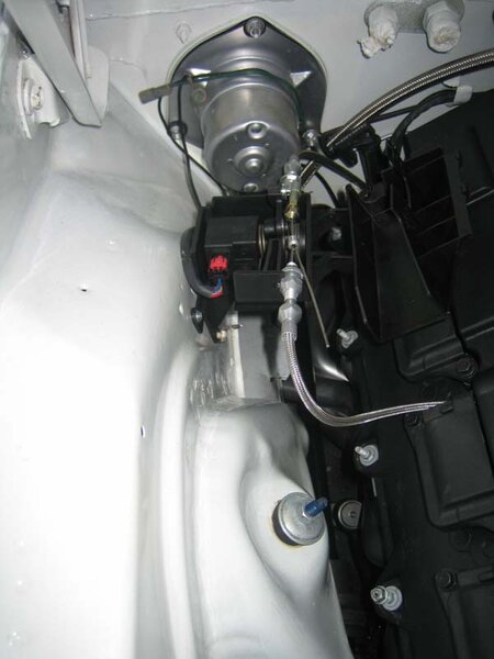

Put your original throttle pedal back in and get an early truck hemi (2003-2004) bellcrank/TPS box that is cable-driven. The drive cable gets attached to your gas pedal, and the box (which can be mounted anywhere that's convenient and out of the way) then plugs into your harness. If the plugs aren't compatible, Sublime sells and adapter for the plug. This should take care of your fusebox clearance issue.
(Pic borrowed from Moparts)
The interesting part is that this box can also be modded to accomodate a second cable to control kickdown on full-automatic legacy transmissions (904/727).
Thank You, I was aware of the bellcrank option. My cruise control plugs into the DBW pedal. Maybe a work around for that as well, but I'm not in love with fusebox location.

From Hotwire.
Between the battery and PDC you see the bellcrank apps. Hot wire has a conversion plug if you need it. I used my original gas pedal and a longer cable.
I used the hot wire set up with a little modification of the relays. I am interested in that wire harness if you sell it.
