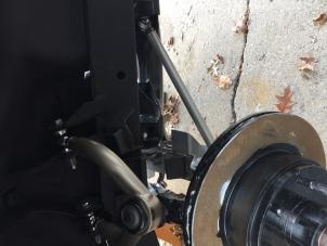

Help!!! I am pulling my hair out. My 71 Duster, the suspension doesnt droop all the way. In fact it is 1.5" off of the bumpstops.

It appears that my upper ball joint is binding on the spindle.
Did I eff up my parts combination? Any ideas? Is the fact that it will not fully droop going to actually be a problem with 1.07 t-bars and Bilstein shocks?

Talk about wanting to pull your hair out! So after a full weekend of screwing around. Lower control arm loosened up, strut rod sloppy loose, lower ball joint freed up, still no change. I pull off the dust boot on the hotchkis upper, reassembled, and started looking. The ball joint cup is hitting the shaft of the upper ball joint, and creating the stoppage. I've got a spare lower control arm, and thinking of buying, renting another spindle to rule them out. I've also got a spare lower ball joint, k781, but all the casting numbers match up, so I wasnt too hip on seapping it out. I just keep coming back to the arm has to be welded off. All the adjustments are the same side to side. Maybe I should rent or borrow a late A upper control arm as well?

Thanks fellas, my mounts have been notched, and like was mentioned with the heim joints I have room for days. No the pin of the upper balljoint is torqueing over into the joint body and stops. I've got a stock arm coming to compare. I am actually seriously questioning my spindle. All the pics and diagrams i've seen show the the top where the balljoint shaft attaches as being angled up and away from the car. Mine seems pretty flat, like maybe it has been bent. Have to completely remove it to clarify. Hotchkis hasnt responded after the initial call and photos sent this week. I really do not want to send it back again, before I rule out the spindle and stock arm. Anybody got a drivers side FMJ spindle laying around?
I re-read your initial posts and the late B spindles are the big question mark in my mind. Is the other (good) side actually drooping to the stop and when it does, is there some clearance left between the BJ shaft and the BJ body? If so, then indeed it sounds like the upper BJ mount on the spindle on the offending side is bent or drilled at a different angle or you have a wrong spindle. Do you have any sort of angle gauge, like is used in carpentry, to look at the angle on the top flat area of the spindle versus the line between the BJ's?
The late B spindles are the same height as the FMJ spindles, they should not be causing this issue. This is further reinforced by it only being a problem on one side. At least it shouldn't be the design of the spindle, there is of course still the possibility of that particular spindle being mismatched or worn out somehow.
