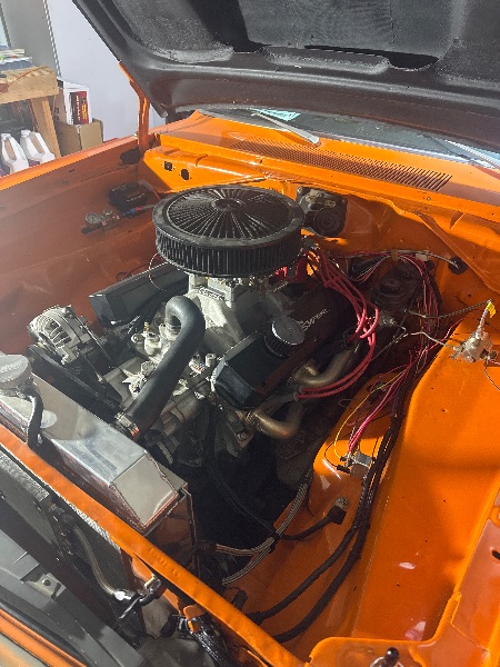

73 duster rewired the car with new American auto wire kit using my previous set with Msd distributor, Msd 6AL box, Holley sniper coil, eddy carburetor.
The current issue I have is when trying to start the car it will not fire up until key is released. I made sure to have both ign 1 and ign 2 wires tied together and connected to Msd box for the 12v keyed red wire. Not sure where else the problem will be since I eliminated all stock parts in the car.

You're losing your IGN2 circuit somewhere from the key switch to the ignition module.
Start at the key switch, or at least at the connector at the column. Make sure you have power there when in the "crank" position (IGN2 circuit); if not, you most likely have a faulty ignition switch or column wiring.
If you do have power there, start tracing and testing the circuit from there forward until you find the break/bad connection.
Even new harnesses aren't immune to poor connections/crimps etc.

Confirm the MSD is receiving 12 volts switched power while cranking. Could be one of the two terminals on the switch isn't working.

i had the same issue, you have to run a "switched hot" to the MSD box, msd doesn't agree with Mopar electrical systems, i have a switch on a panel that i flip so the car will run, kind of a PITA but its worth it
The OEM blue and Brown ignition wires need to be looped together. However AAW runs out of the column plug, got to get those two together if using the Mopar igninion mechanism. Put a test light on it to make sure it's hot in start position. Get that trash can running would you.... :) I see you have them looped together. Test light it. Might be the switch mechanism at key. Probe the column connector as well.
Where is the main power wire for your MSD connected?

If the engine cranks in the "crank" position, then obviously the entire brown wire start-circuit is working.
If the engine previously ran in the "run" position prior to the swap, then obviously the entire run-circuit was working.
Therefore, I agree, that the problem must lie in how you spliced those two circuits.
Part-2
On my car splicing the brown and the yellow together, caused similar issues. I installed an aftermarket relay to send battery-power to the CDI box, triggered from both wires, and a DIODE on start side, to prevent feedback to the starter-relay; which solved the problem.

I believe main power to Msd box is off the big stud on the mopar starter relay which worked for me before the wire harness install. I’ll have to prob the column conector and go from there. Thanks

IIRC that stud is Hot all the time, even with the key off. So, if you do this, how does the MSD know to shut off. I mean, I've never had an MSD, so IDK.
Confirmed I have 12v at the Msd box while cranking. No issue there, as well as the ignition switch. I did pop the distributor cap off and saw a good amount of corrosion so I’ll be cleaning that off and go from there.
Feed main wire does not have 12v while cranking but does in run position
