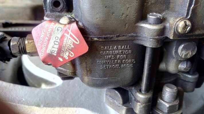

Have a look at Rockauto. They sell an Autoline C6018 carb which is in fact a remanufactured Carter BBS ball&ball.
I have one on my slant and it works like a charm
Carter BBS carburetors seem to be far better than Holley 1920.
