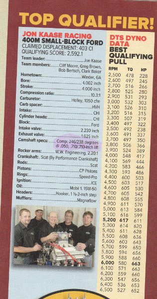

I have been using reverse pattern cams for years. Jon Kaase won the engine masters contest with a RP cam. He was very naughty: used very short conrods; used very tight LSA cam, 92 LSA.
Lsa on that cam was 98 installed at 92.
And in later engine masters comps that engine had a 256/264 @050 on a 108 and made a bunch more power, not solely for that reason though. Reverse pattern cams don’t work. That’s why no one uses them anymore.

It really is nonsense to claim as a blanket statement that RP cams do not work. In the same EMC contest that Jon Kaase won, post #65, He also had a 429 Ford entry that had a RP cam, 264/256 @ 050. He came 5th out of 29 entries listed in the results in PHR magazine in Feb 2009. His engine recorded the highest hp, 746, of those listed.
A recent trend has been to use lower ratio rockers on the exh. If the cam is a single pattern, you are effectively converting to a RP cam, acknowledging that the extra lift & duration is not needed.
