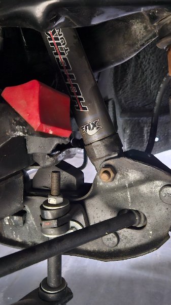

It really depends on the set up that you have now, which doesn't sound entirely stock at least by your description. Can you post a picture of what you have now?

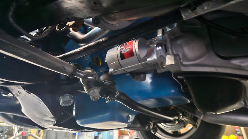

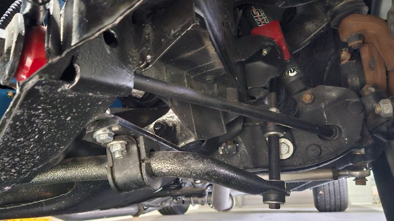

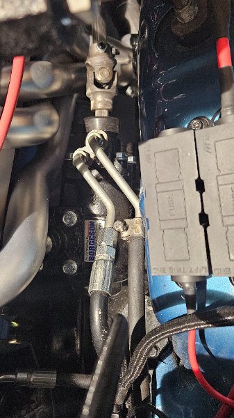

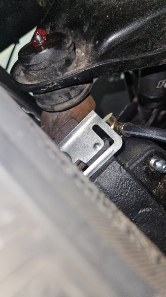

Ive attached a few photos of the current setup.
Looks very similar to my 73 Duster.
1.03” bars, Helwig sway bar, Fox shocks, Borgeson, … but I have Gen I SPC arms and QA1 lowers. 225/60-15, Cordoba brakes.
I daily mine most of the year. Very sporty handling, just a touch harsher ride but very much worth it. I would call this like an optimized OEM suspension. You are very close to it so I would recommend getting the UCA’s you really want.

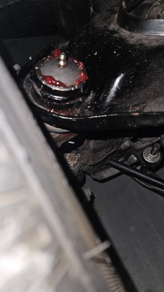

Is this the issue you're concerned about?
20251203_122605-jpg.1716485312
The zerk fitting just needs to be tightened. If the zerk threads in the upper ball joint are stripped you might have to use a zerk with a larger fitting on it to get it to seal again. If the ball joint is good then the zerk fitting isn't a huge concern as long as the ball joint has been greased appropriately.
Do you recall what the alignment specs were when you had it aligned? 215's or even 225's aren't wide enough to require a whole ton of caster. You do want a few degrees of positive caster, but you don't need like 6°+ like if you were running 275's up front like I do.
Which is not to say you can't switch out your UCA's or that it wouldn't be an improvement, but you certainly don't need to replace the whole UCA just because of a bad zerk fitting. A zerk with larger threads, or at worst a new ball joint, would solve the issue without changing the UCA's. Now if you want to change the UCA's and get more caster than you had before (whatever that is), feel free to carry on!
Thanks, I'll check the bumpers. I believe there is a black lower bumper in place. The original owner installed those.
And 72blu - I took a photo of the good UCA side, so I went back and took a shot of the problem side (below). I have pretty much decided to get QA1 upper control arms.
Oh! Yeah, that ball joint is shot. The "cap" on it shouldn't have much to do with the operation of the rest of it, but it's gonna leak if nothing else. Wouldn't give me confidence on the rest of the assembly though.
At the minimum you need to replace that ball joint, although that doesn't require upgrading to tubular UCA's.
Um, QA1 has had some manufacturing issues with the passenger side UCA's lately. FirmFeel also sells tubular UCA's at about the same price point for the large ball joint UCA's Firmfeel Mopar Suspension and Steering
I'm sure QA1 will sort out their issue, but there have been a couple members here that have sent back QA1 UCA's recently. QA1 has replaced them at no charge as far as I know, just FYI.
