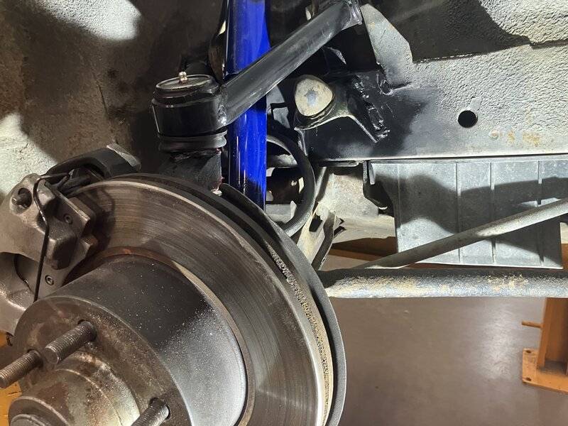

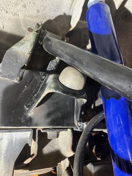

Unacceptable: tubular upper control arms with no bump stop pads.
Guys, I hate to say it, but if you look at the pictures of those arms you should clearly understand that they won’t contact the factory bump stops. The geometry is completely different, it should be obvious if you think about it.
Not true. The pic below is the same manufacturer on PST's website selling B Body UCAs. I have these on my Coronet and they contact the bump stop.
I didn't buy the arms. I'm helping a friend that bought them.
I bought these UCA's, along with several other parts from PST back in January to go along with the 5.9L stroker build I'm doing at Greg's shop, since we were dropping the K frame anyway. I have a full assortment of suspension pieces from PST on my Coronet, including tubular UCA's, and I've been very happy with their product and customer support. The UCA's contact the bump stop on the Coronet.
So I purchased these UCA's for the Dart based on prior experience. PST's website makes no note of the bump stop issue. There is a note warning readers that 1973 and up disc brake spindles must be used for these UCA's. They could have added the bump stop clearance as a note. In fact, they could make more money by fabbing a bolt-in bump stop relocation bracket and selling it as a recommended part add-on for hobbyists that don't weld.
It's not the fabbing that's the irritant here, Greg can weld and has fabbed countless brackets for his cars and mine. It's because the vendor chose not to disclose and the purchaser has to find out during the install.
I think B-Bodies have their bump stops in a different spot that makes it work. Even the factory A-Body arms have a flair to them to get them over to the bump stops.
Apples to oranges
Apples to oranges
No its not. If everyone knows that A bodies are different, then either engineer the part to fit, or sell an offset bracket as a complimentary add-on.

Yeah you’re going to have to come up with something to have a limit for that suspension extension. At least I would on my car.
What I said was 100% true for A-body UCA’s. B-bodies are a whole different ballgame, comparing the two is apples to oranges, and if you didn’t know that then you didn’t have enough information to be making a good decision.
No it’s not. If everyone knows that A bodies are different, then either engineer the part to fit, or sell an offset bracket as a complimentary add-on.
It’s a bump stop. If you’re not familiar enough with your suspension to look at that arm and see it’s going to be an issue maybe you’re not familiar enough to be making that decision.
You’re modifying the car with a part that is clearly not the same design as stock. Expecting every aftermarket company to hold your hand when you’re making modifications isn’t realistic. None of the companies that make tubular UCA’s will tell you that they clear or interfere with 9” wheels or 275mm wide tires, but some absolutely won’t clear them on an A body.
That design has been around for decades, on an A body that design will not result in contact with the stock bump stop. A quick search here will show you multiple threads and pictures of modifications needed for various aftermarket UCA designs.
If it was that big of a deal, you should have returned the parts and bought the more expensive QA1’s with the bump stop plate included.

Best idea I can think of for those SPC 2.0 arms is a limiter strap like I see on some heavy drag race builds or the 4x4 rock crawlers use.

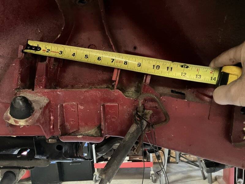

This isn't the only issue Rich and I are having with these UCAs...
The left side UCA had mounts that were a strong 3/16" wider overall than the right side. Measuring over/over, the stock control arms were approximately 9 1/2". The 72 Duster I rebuilt last year was 9 3/8"
The PST left arm was just shy of 9 3/4", requiring me to mill down the aluminum end spacers/caps to get the arm to fit in. The right side went right in.
BOTH arms were installed with the alignment cams adjusted the SAME way....front cam OUT toward the fender, rear cam IN toward the engine.
Late last year, I used my gauges on the car and found it had 2 degrees of positive caster and bear zero camber on BOTH sides. This is with stock UCAs with offset bushings.
When we tried to align it today, the left wheel cam in with a fantastic 5 1/2 degrees of caster but only about 1/4 degree of negative camber. That is fine, I could give up a slight amount of caster to have a little more negative camber.
But....
When measuring the right side, it was 1 1/2 degrees of POSitive camber with 4 1/2 degrees of NEGATIVE caster.
The owner installed PST adjustable strut rods and they were installed at the same measurement of what the stock arms measured. We cranked the RIGHT side strut rod forward by 1/4" and rechecked the alignment. The camber was almost the same at 1 1/4 degree POSitive but the caster was still the same.
How could that be? I moved the lower ball joint forward by 1/4" and saw NO change in caster?
Well.....
Looking closer, the NEGative caster on the scale STOPS at 4 1/2 degrees. I tilted the gauge from it's base and found that I was surely well past the 4 1/2 degree number. Who the heck knows how much negative caster we have at this point. The RIGHT arm is simply built wrong.
We started measuring from several points and found that the zerk on the top of the upper ball joint is 1/2" further forward on the right than it is on the left.

We measured at several points. The wheelbase is 111" on the left, 111 1/8" on the right.
We measured The frame rail bumper bolts to the upper ball joint zerk, bumper bolt to UCA bumpstop bracket/mounting hole. Width of UCA mounts in the frame, everything I measured regarding the car itself was always within 1/8" from left to right.
The RH UCA is mounted into stock mounts that are in the right place....it is the UCA itself that was built wrong.
No, I should not simply accept this since it is "not a stock replacement part". Making excuses for this reflects poorly on anyone that says it.

I put QA1s on mine, they had bump stop plates welded on the tubes that perfectly aligned to factory bump.stop, and zero issues dialing in Caster and Camber. I did have to spread frame mounts to get them to fit in and had to bend the one mount area like everyone else had to do. But overall zero hassle install for the most part. And I lack experience with Caster Camber adjustments like you have.
