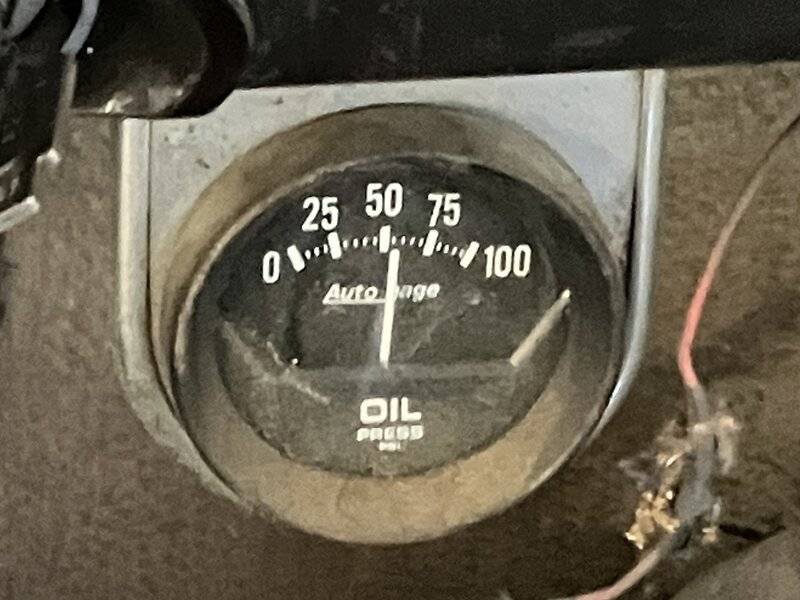

I will change the oil and try another oil pressure gauge first.

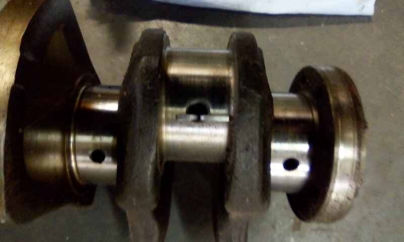

I would bend up a cotter pin to slip into the oil hole, funny angle thing and just rotate the crank.
The cotter pin "flukes" laying across the bearing surface would just push the shell around till it'd pretty much fall out when nearly all the way around.
Just lay the new shell on the clean/lubed crank surface, finger pressure to get it started, the cotter pin/rotate shaft till you can engage the "tab".

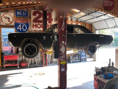

I bought the lift in 2015. I built the shop in 2006 with the intention of installing a car lift.
I am still fully capable of "flat back" work but this is so much better. I lose perspective of what is the left and what is the right when I'm laying down. Standing while working is a lot easier.

i was just goofin' about the lift. i have one too, and while it's sooo much nicer to work standing up, it seems like i've always got a car on it and one underneath torn apart and unmoveable and two parked up land locking evertything. which, now as i type that out sounds more of a "me" problem than i'd care to admit.

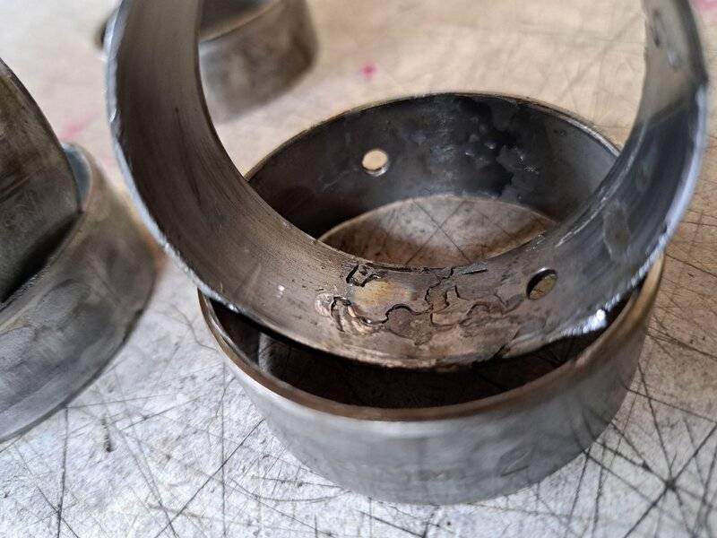

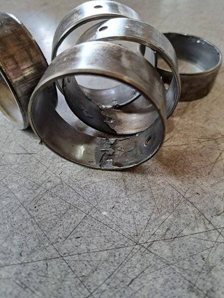

Of all the engines that I have torn down to rebuild, very few had cam bearings worn much. The ones above didn't wear, they rotted from contamination. Bearings don't flake and chip apart from wear.
I have heard/read that magnum cam bearings wear more than anticipated ??
i mean, think about what they came in: trucks (mostly) and what gets abused more than work trucks? more likely to neglect OCI and maintenance? (*coughs* besides rental equipment *coughs*)
the "flaking" of cam bearings has also been (loosely) linked to the acid/acid by products in modern motor oils, namely synthetics-- which again, goes to extended, missed or ignored OCI's.
so, little wonder the cam bearings are pooched in a lot of magnums.

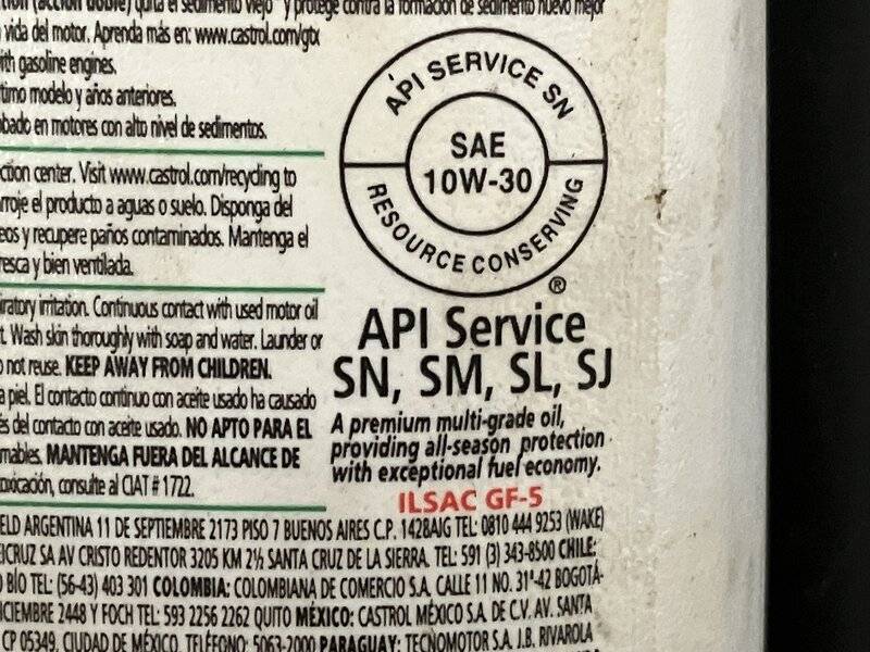

Backing up a bit, here are two bottles of Castrol. Old on left, new on right.
Remember, the old stuff was API SF.
Again, fine for newer engines but no zinc for us classic car guys.

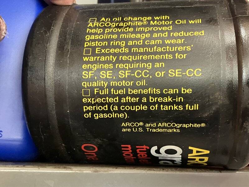

4 1/2 quarts of vintage ARCO Graphite and….
55 PSI at cold fast idle. 20 at hot idle in gear. That is plenty good enough to forego a bearing swap. The old oil looked clean but drained out like water even with the engine still sort of cold. I only ran it long enough to move it to the other room.

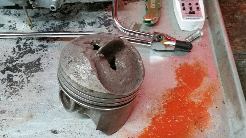

Those look just like the cam bearings in the Hemi Charger Dad gave me (back in 1983) after he dropped a valve and drove it for five miles, embedding the valve head in the piston and knocking a hole in the head.
Cam was fine. So were the crank and rods. Don't know if the condition of the cam bearings had anything to do with the dropped valve, but I suspect they were already bad, I'm thinking from being damaged by some yahoo who installed the cam in one of the two earlier rebuilds. I've never seen cam bearings like this in any of the other engines I've had apart (maybe a dozen or so).
