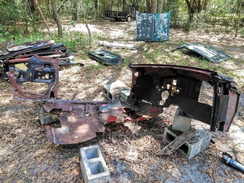

What I ended up doing... got a little aggravate with the whole process. Just kidding..
