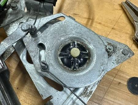

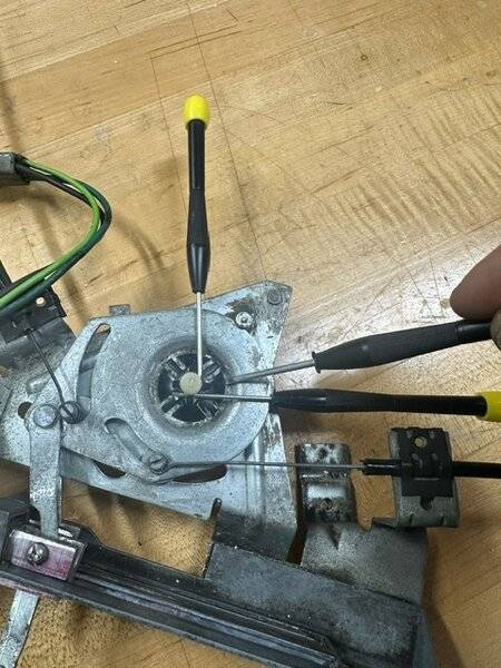

68 to 72 A Body
The black plastic retainer is a bit more complicated.
@seanner used 2 small screwdrivers to lift up 2 of the tabs, and another to lift the retainer up enough to get the 2 tabs over the lip on the shaft.
He repeated this for the other 2 tabs and the retainer came right off.

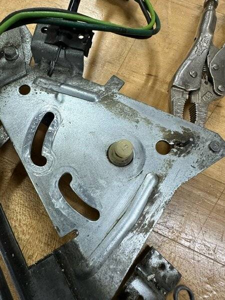

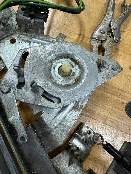

Once the clip is off you can lift the plate off.
Replace the pins. Be sure the orientation is correct.
67 A Body and 69 to 76 Truck
68 to 72 A Body
Put the plate back on and reinstall the retainer. Be sure to clean and lube the wear points.
