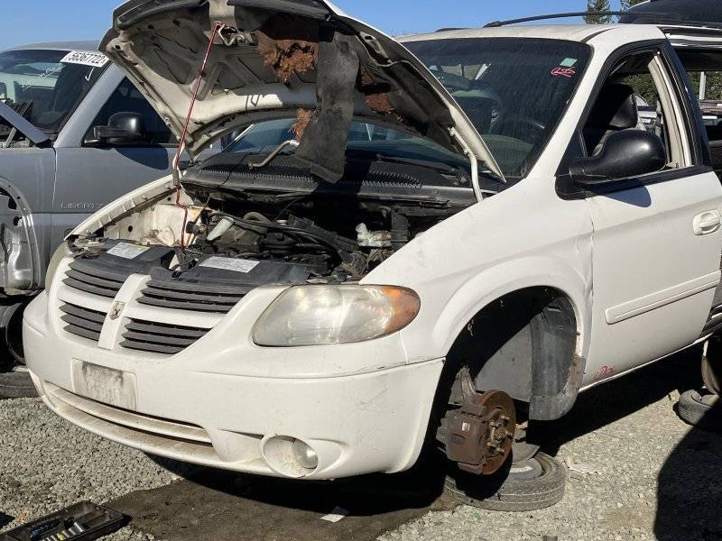

Dodge/Plymouth Neons, PT cruisers and Mopar minivans!

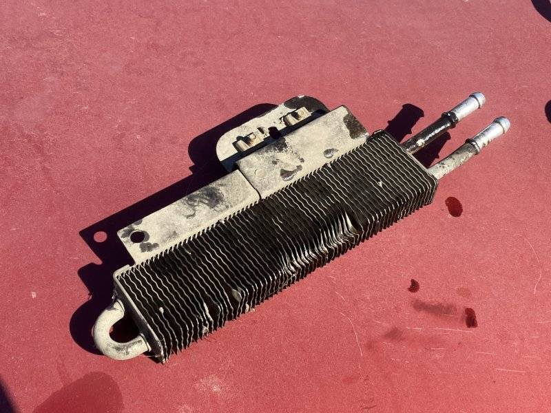

Here is one I pulled from a Neon:

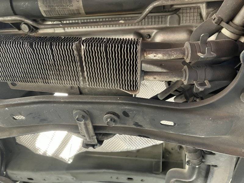

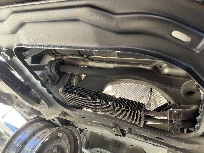

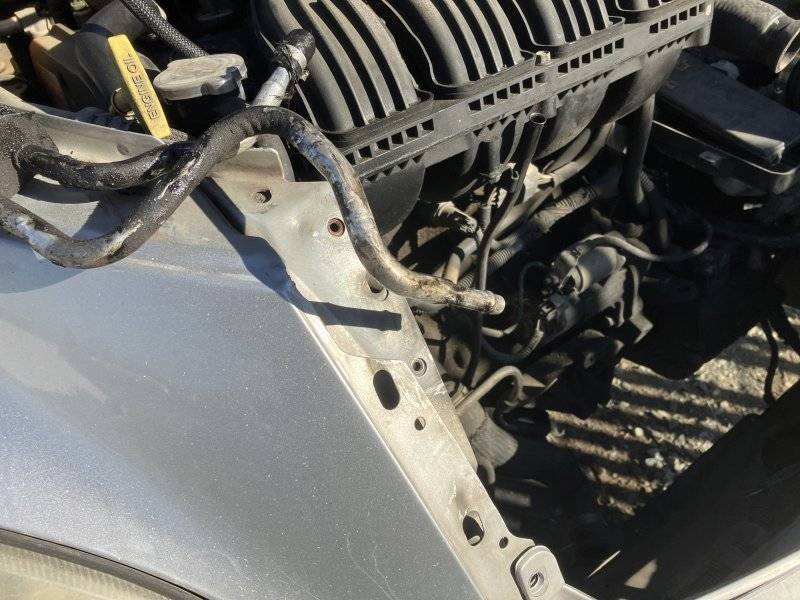

These are aluminum. The lines are 1/2” but they are swedged down at the ends. The lines are a little weird but they could be shortened. I looked further at other cars and found that these models are even better:
Their design is better since the nipples are close to the body of the cooler.
They are really easy to reach, too.
There are two 9mm bolts to remove then just cut the hoses. One minute if you are slow.

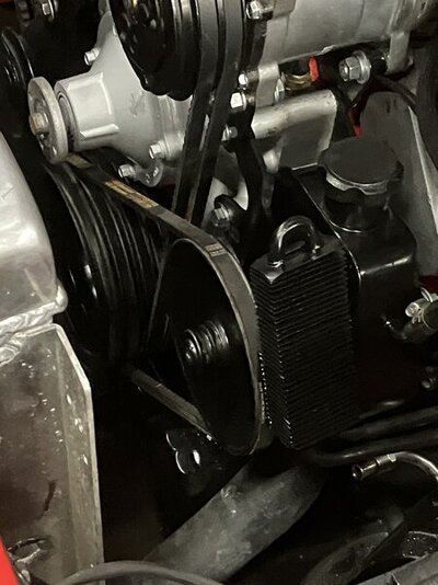

I agree in theory but this is how it was mounted in the Diplomat Police car.
I kept it bolted to the face of the pump....actually to the bracket on the front.
I'm sure that works fine- it's only the parts of the cooler and lines that are above the "full" level of the reservoir that will drain back. A little ain't bad. You just don't want the whole thing too high, because the volume of the cooler and lines can be substantial.
