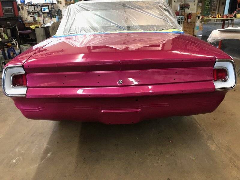

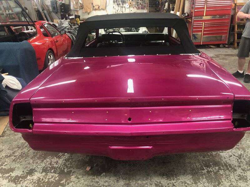

More fun with my '68 Bcuda Restomod project ... As some of you know, we've came to realize a few weeks ago the replacement trunk lid we were desperately searching for over a 6 month period in 2023 came from a '67. The aftermarket lower valance we ordered from Classic Industries is a 68/69 is painted and installed, but now needs cut-outs to accommodate the '69 Backup Lights since we will not be using the '68 taillights that have built-in back-up lights, as they mis-match with the '67 trunk panel detail.
Hoping one of you out there could respond back with:
  • the actual hole diameter measurement
  • a photo of the hole, in the event there are holes needing to be drilled to attach the bezels
  • measurements to edges or on-center from some usable reference point

This sounds like a nightmare situation to align it correctly. I’m in Tucson for the winter and the car is with the build shop in The Washougal, WA. Might just push this off until Spring or forgo backup lights altogether. Given my car is a ‘68, do you think there are going to holes in the rear crossmember, as the ‘68s didn’t have lower backup lights? Also, I’m not clear what you were conveying in your comment “The repo scare the length of the 67s from what I have seen.” Could you elaborate a bit?

Man-o-Man!! ... I'm going to push this off until I'm back up there and can eyeball this for myself. Thought the CI 68/69 lower valance would imply using the '69 backup lights, I think I should measure and look at it's depth the bumper to make sure the '69 bezel doesn't sit too proud.

Totally get your point, but I'm past the point of no return on this car. It took 6months to find a usable trunk lid (e.g. the '67) and now the whole car is painted. If we could ever find a usable '68 lid, it would be challenging to paint the thin with the gray undercoat and 5 custom magenta paint layers to exactly match (we do have the formula). After realizing this quagmire, I actually prefer the '67 truck/taillight config to the '68, as the stark white on the taillight assembly detracts a lot from the rest of the car. I also don't sense a '68 trunk panel will properly attached to '67 trunk apron, and the predominantly black '67 panel plays nicely with the overall scheme/theme of the car.
Peter Bergman already scolded me for painting the engine bay black, sighting that the MOPAR purists are going to crucify me for it and would hurt the value. As I told him, we're building the car for our taste and use, I'll died before ever selling the car, so might as well follow our vision and avoid the societal group-think conformity IMHO :).
