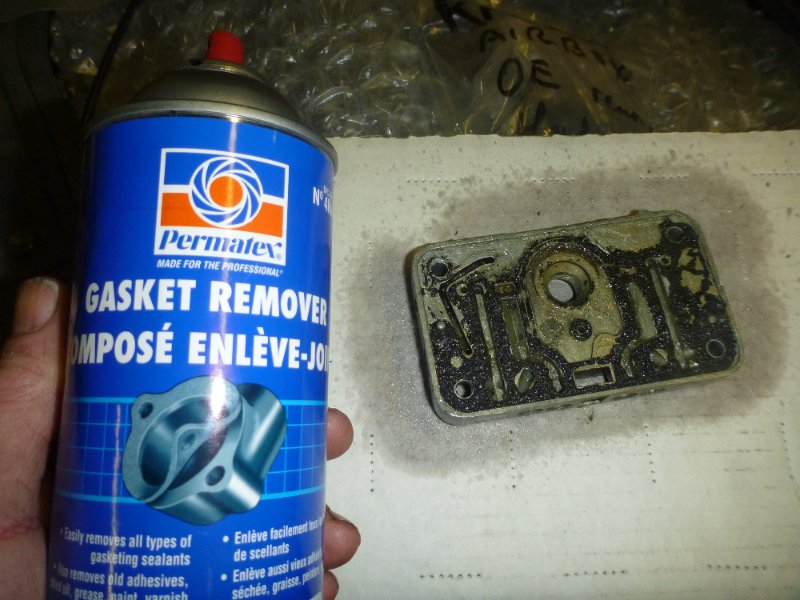

follow up with a little acetone and maybe a "how's your mother" with a scratch pad if needed.

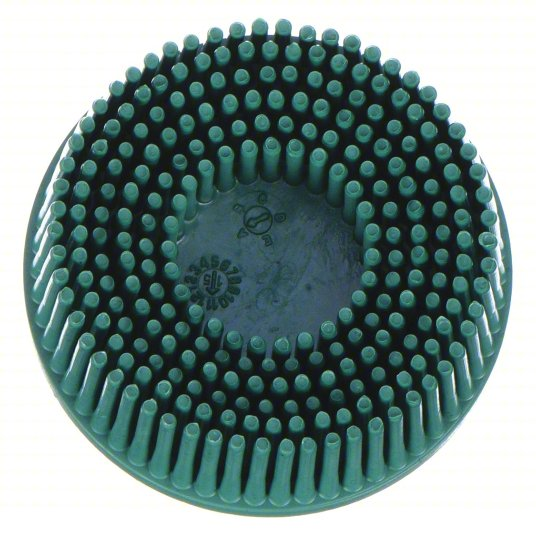

Sorry to say this but many years ago GM found that many bottom end engine failures were caused by 3M Scotchbrite residue from prior warranty repairs like resealing intakes or head gaskets. If you are using anything in a rotary tool, use a Bristle disc. They have plastic fingers that don't produce harmful grit. They come in different diameters and grits. Scrape the most of the gasket with a razor blade scraper.
I use these discs too. Love them. Last a good while too. I thought I remember them having steel bristles inside those plastic bristles but I have not paid attention to it in a while.
Now you tell me. Since I haven't turned the motor over, I was going to flush the cooling system with running water while I have the water pump off and dump a gallon of diesel down the head oil drains with the drain plug out. I can't see how much of that could make it to the mains with the oil filter in place....
