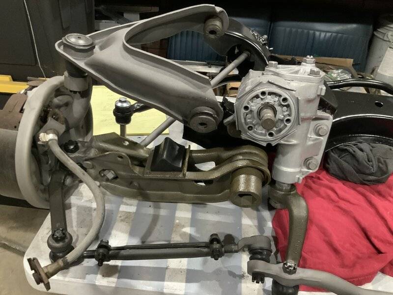

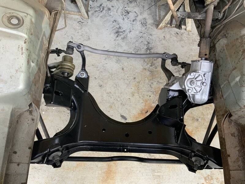

I cleaned it up then (
@dadsbee) advise put hot wax around seals then taped up with red stucco tape then Bead blasted it then high temp clear coat came out awesome.
