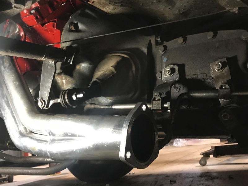

Ok, so I found some pics from when we put the engine in on my phone. A cool 6 years ago. It’s my buddy’s truck. I’m kinda married to it now. There is a whole lotta wrong going on there as far as clutch rod. I don’t see a spring or the correct bushings. This has kind of been a make it work to get him back on the road kind of thing, and although it should have been done correct the first time, we used a lot of the old set up for reference and in practical use. I would assume use the one for that bell? My friend went out of town Thursday morning, so I have no current images like he was supposed to send Weds. measurements and stuff
Hahaha. You mean why is one of the nuts. I stated above, we kinda used what he had on hand. I would venture to guess the clutch fork riding on the threads between the nuts has something to do with it. I’m not trying to find out why it was getting stripped. The correct part, or kit is what I’m after. I’m sure the big block valve spring retaining washer isn’t supposed to be there either.
