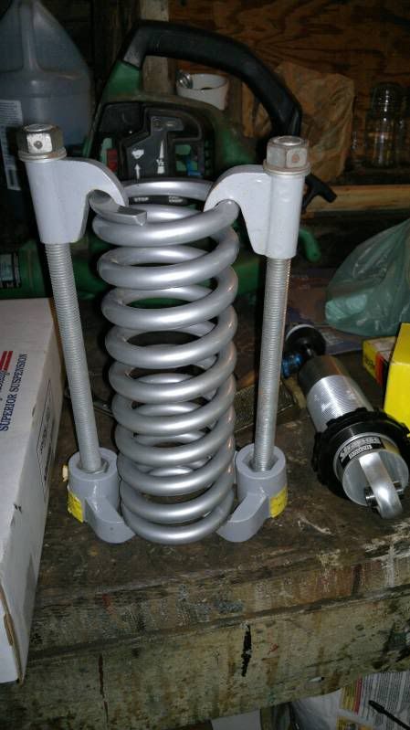

I'm trying to assemble my QA1 springs onto strange coilovers for badart's suspension and I'm having an issue with actually getting the springs on. I've tried two different coil spring compressors and both didn't work, couldn't fit between the coils and even if I got them on the shock would be blocked from going through the center. I have to compress the coils because I can't get the spring retainer on unless I do, even with the adjusters backed up all the way to the knob. If I took the knob off I could back the adjusters off completely and then get the spring on but they say on them specifically not to dissemble them. If anyone who's done this before could chime in it would be much appreciated.

Maddart maybe I'll have to find someone who has one of those that I can borrow, I can't justify $55 for a tool I'm going to use for two springs. I just have to compress them a tiny bit, considering using some kind of C clamp to compress just one ring.
Your going to use it more than once. Most guys it takes a few sets of springs to dial their car in right.
You can get some all thread some plate steel and make this yourself for less than 10 bucks. Time = money so that is why I just bought mine.

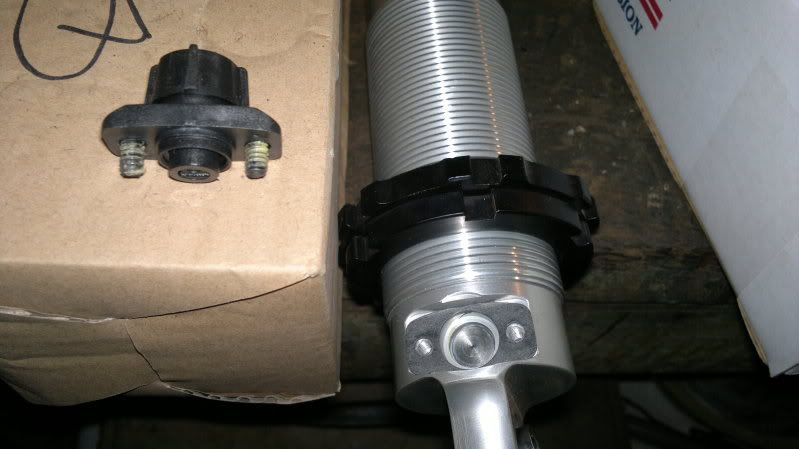

Just wanted to update with the solution I found, in case anyone in the future is searching for this.
I figured it out after a little research on the adjustment knob, found that it's a replaceable part they you can order from strange so I took that and ran with it. Came to the conclusion that I could remove the knob assembly, which then gave me enough room to back the adjusters off the bottom and get the upper retainer in place. Voila, coil springs.
