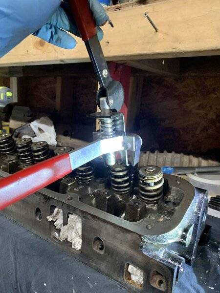

Okay so the spring tool seems like it will work, now that it’s properly oriented. I’m not understanding the retainers. Even though I’m afraid small, high speed projectiles will fly into the abyss, I gave a few taps with a socket on the retainer. Nothing. Hitting it harder seems like a bad idea, and I definitely can’t hold a hammer socket, and the valve to register any change. I originally thought the retainer won’t go anywhere unless you depress the spring and release the pressure first?
I was mixed up thinking the stem tip sat below the retainers, Rusty, but the stem protrudes. I can’t hit the retainers with a hammer without hitting the stem (I didn’t) unless a socket or something bridges the valve stem tip.

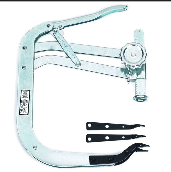

I got one like this, but I only use it for removing springs that I know I won't reuse. If the fingers scratch or mar the spring they are junk as that creates a stress point for breakage. It was given to me for free and it is a POS, hard on the wrist and the fingers keep slipping off.
This is the one you want, it doesn't touch the springs at all.
Don’t scratch the springs while using metal tools and hammers to remove them? Is that real? Seems impossible.
You don't want to hit the locks! Just give that big retainer a good smack. If you like put a 5/8 socket on top and wack it!!
I hit the locks a few taps. I thought the locks were the retainers. Is the retainer actually what caps the spring and look like a washer? I was literally about to start hammering harder on the little pieces that lock the spring to the stem.

I'm with the others you MUST "bump" the retainers to get them unstuck. I use a socket large enough to clear the valve/ retainers but small enough to not slide off the retainer. Don't hit it real hard, and have the head jacked up (if removed) on some rags and scrap wood. That way you won't accidently drive the valve heads against the bench
Yes the big thing is the retainer. Don't hit the locks.
If the idea of whacking the valves scares you, you should see how a major engine remanufacturer takes things apart! I've always used a socket and hammer to loosen things up before taking cylinder heads apart. As long as you don't go "Godzilla" on them, it's all good.
Yup this is what i do. You could also squirt a little PB blast near the locks(retainers) then a rap with a hammer and socket just to shock em loose then the c clamp spring compressor then I use a magnet to fish the locks. I never want my fingers down there in case the compressor lets loose...

The lisle is intended for use with the heads mounted on the block.
With the heads off, there are better choices.
I have used the lever type, and also an air-powered one. Neither could do solid roller pressure springs.
So, I modified a giant US built C-clamp. 900 lb springs? No problem at all.

I’m at the valve springs to change the seals for my 360 swap. Head off, I cannot budge the springs with the Lisle compressor, and feel like any more force will break or damage something. I can get the spring to slightly lift from the bottom, but will not depress at all to reveal the keepers up top. You need 2 hands to operate the tool, but it will release if you let go. I was just testing if the tool worked like I thought it should (it doesn’t), and didn’t even figure out where the extra hands are coming from to catch the keepers, and reinsert them while I bear down with all my might, on this tool/spring. The $30 spigot knob type look like you can actually let go once compressed, this $50 compressor seems like it wants to hurt something, and doesn’t compress anything with me using it. I’m pushing the upper lever forward to compress, maybe orient the upper handle so I pull down toward the other handle? I’m a strong guy btw.

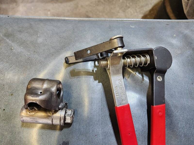

So is this thing a pos, am I using it wrong (probably), or do I really need a helper to remove springs? Lisle valve spring compressor:
That's for using with head still bolted on engine & you put AIR PRESSURE in the cylinder to keep valve closed . Then you change the springs
Do leakdown test to be sure valves will stay shut. & then hit retainer w/ brass hammer too loosen keeper before putting tool on.
You have to rotate the upper handle (you have it backwards in the pic) and pull it down towards the lower handle. It will work but is a pain to use.
I used one of those a few decades ago. I bought a c clamp over the head type which is much better (easier,less slippage).
I used one of those a few decades ago. I bought a c clamp over the head type which is much better.
I wouldn't call it a pain, but it is a little slow. That said, is it a job you really want to rush?

I use a properly sized hose clamp to hold the jaws on. It slows it down even more, but I don't mind. I don't use it enough to really give a damn anyway.
