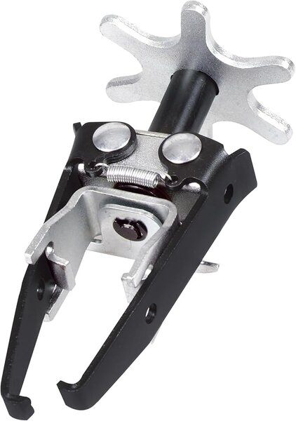

Well I've got the cam break-in period accomplished as per instructions by Hughes Engines. The break-in was done using "only" single valve springs. Now for the "suggestion." I'm trying to install the required "secondary springs" (inner) using the tool I have. I cannot compress the springs enough to install the keepers. I've got the valves held shut with compressed air and spring removal was easy, but the installation of the double springs "ain't workin." I sure don't want to remove the head (I will if absolutely necessary). I'm open for suggestions. This is the tool I'm using.

I used that tool to do my springs recently. When you put it on the spring and before you start twisting on the top, turn the tool clockwise to wind it down onto the spring. This will in turn give more compression on the spring. I also found that on some of them I had to give the top of the tool a smack downward to kick the spring free of the keepers. Finally, using a tool with a magnetic tip helped in removing the keepers.

Those type of spring compressors are junk. I went through 2 to do both heads on my 318 with basically stock springs, no way you could do double springs with that type of tool.

Mine (Lisle) has held up just fine for over three decades.
No kiddin. I have one from KD that's about as old. I mean really, you have to know their limitations. Stock springs are "about it". I've lost count how many valve seals I've replaced using that tool.
