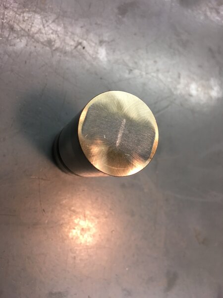

Hi all, I have a 67 Barracuda with a 273 Commando mill. Before I got the car someone else replaced the original camshaft with a larger duration HFT. This didn't work too well for me, so I replaced it with a Comp XE262H HFT stick around two years ago. I noticed recently that there was a slight 'ticking' noise coming from the top end. I removed the intake and rocker gear to find cylinder 5 exhaust lifter had a slight wear mark, straight along the face of the lifter (actually looks worse than it is in the attached picture). Looks like the lifter wasn't spinning in the lifter bore. From what I can see all the other lifters have a nice circular, consistent, wear pattern - they all look good except No.5 exhaust.
The cam lobe for No.5 exhaust looks good to me also (pic attached for reference).
I've bought a single Comp lifter to replace the worn one and was thinking to use this hydraulic stick in a 318 build.
What do you guys think?

Measure the lobe, compare to the rest. That’s the only way to know. Looks like the lifter took the majority of the damage but eyes are not measuring tools.
Like above, and be sure the taper across the lobe face is similar to the others. And confirm the lobe will still spin the new lifter in the bore with no pushrod installed. Put a dot on the top of it to confirm.
That lifter is trash. The lobe on the bottom in the picture above is also trash. The lifter stopped spinning.
The lifter bore needs broached. Double check that the lifters are all spinning before finishing up with the new cam and lifters.
Yep lifter failed & so will the lobe that it rode on.
To make sure it doesn't happen again:
- find some factory lifters & have them re-faced by Clive Cams, they are in country Vic, [03] 9758 5977. I have had many, many sets of lifters refaced by them, all had a superb finish.
- they may be able to regrind your cam; if not, Isky 262 Supercam is close to what you have. Not cheap, but good quality.
Thanks all for your good feedback, I'll definately check No.5 exhaust lobe with a vernier to compare to the other lobes. Bewy, I do have a set of old, used hydraulic lifters to I will send to Clive Cams to resurface. I might just give them a call and see if they can check / repair the associated cam lobe. Good advice, thanks.

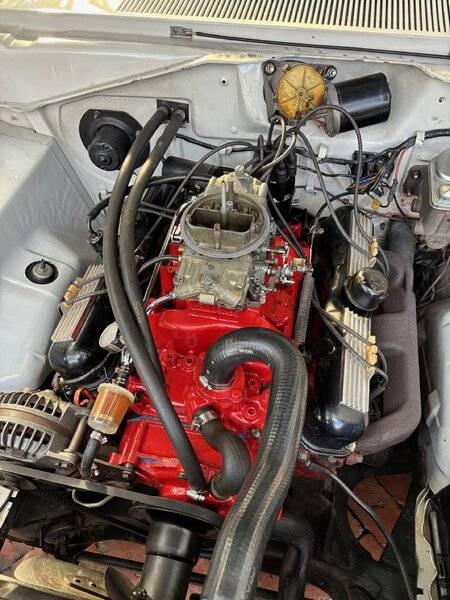

273, I bought the 67 out of Canada in 2020 and had it shipped to Melbourne, Australia. It was in fantastic condition, the 273 was rebuilt some time back and ran well, except that someone installed a big duration hydraulic stick that sounded great, but was really soft on power off idle and mid-range. I installed the Comp XE262H cam and noticed more vacuum at idle (steady 14 inches) and more power everywhere. The little 273 is supposed to be a Commando mill, but when rebuilt in was done with 2BBL pistons which yields an estimated 8:1 static comp. If the 273 had more compression (9-9.5:1) it would really make a difference with the XE262 stick. As it is now, I had a no-name hydraulic cam with matching lifters in my stash from a rebuilt, low mileage 318, that's supposed to be 'one-step up' from stock. I installed this stick when I found the worn lifter on the XE262. The no-name cam works great in the 273, idle vacuum is up to a steady 18 inches and the 273 runs the best it ever has. It's a 4-speed car too, so it's a lot of fun driving around even though it makes little power.
As a side note, I took off the Edelbrock 600 carb I've been running last night and installed a nice Holley 600 DP I had. Runs great, idles better and seems to make a little more power everywhere, judging by the 'feel by the seat of ***' meter. I also have the original Carter AFB 4924s & cast iron 4BBL single-plane intake in storage.
