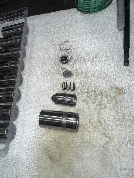

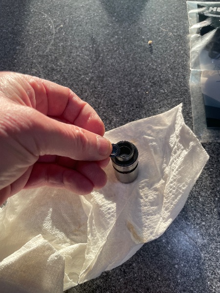

Is there an incorrect way to install this disk? There’s a raised circle around the center of it. If the raised section is up, could that cause it not to build pressure in the reservoir inside the lifter above the ball?
Reason is it still seems like that new lifter is bleeding down. I did pull it apart to inspect it and don’t recall which way I put that disk in.
I have a new one here if you'd like me to disassemble it and see.
That disk is the pumping mechanism for oiling through the prod. It can go either way. The pressure that the lifter builds up to maintain zero clearance & quiet operation is below the inner piston, not above it.
