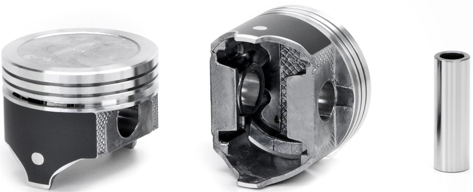

Stock open chamber heads are in the 73cc range. Uncut, with a regular headgasket, the tend to measure in the 9.5:1 range. With the piston barely below deck, the valve reliefs in the piston and the large chamber, they don’t break 10:1 without milling, nailhead valves, thin headgaskets, etc.. Calculated compression vs actual tend to be very different.
And even if it does hit 10:1cr, there’s nothing wrong with that in a streetcar running good gas.
They are far from all the same. I've seen them as small as 67cc. I'm not arguing the point. I'm telling you what we ended up with. Go for it. Build it at 12:1. It's not mine. My car runs great.
at 8000 elevation a high compression ratio is not going to be an issue.

Thank you all, busy days moving into my new home. But I'm reading everything. I didn't know that a post with the "high altitude variable" could be that interesting. The car is being worked on in Miami, I'm buying the new parts little by little and now I'm thinking about Silv-o-lite 1279HC + Comp XE256/262H... And I just realized that I'll need a new radiator
