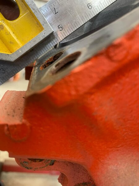

Very sorry for delay, totally forgot.
I get a measurement of 1.350 from top of pin hole. (.980?)
I mentioned no .060 pistons for 340 to my son.
He went to Summit, found Hypers? 4 sets remaining, .. (I didnt see it.)
