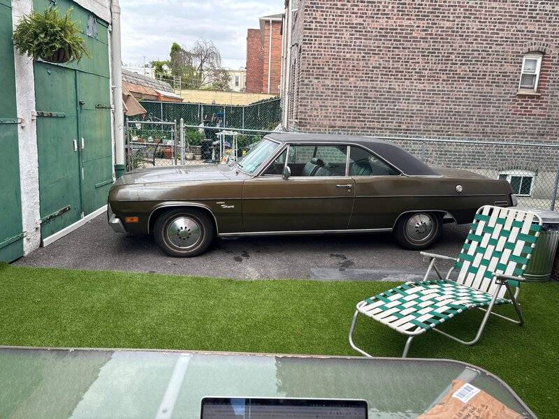

Hey guys, I had another thread called "What to Do with My Scamp" in which I described how I have a slant- six equipped 71 Scamp with oil pressure problems.
At the end of that thread, I decided to pick up a 5.9 Magnum to replace the worn slant six.
In this thread, I want to chronicle my build and ask some questions along the way.
My goals with this build and swap is to do it as cheap as reasonably possible. I also want to have the engine make decent power, but have great street manners. I have done the hot rod thing, I've had a 440 4 speed, multiple cars with lumpy cam and headers, and this time I want to make something that has good torque but is fairly civilize and super reliable.
Actually, what I really want is for this Scamp to be a dependable, comfortable daily driver.
