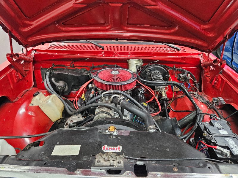

Hey, it’s the dumb kid again. After all this time, I finally got the bottom end done on my Magnum and I’m getting ready to do the top end. I got some new used Magnum heads that are not cracked, and I’m going to send them out to get rebuilt. I would just like some clarification on my build.
I am doing a /6 to V8 swap in my Duster, and the goal is to have a fun street car on a budget. Right now, the motor has a stock bottom end with new OE .030-over pistons and ARP rod bolts. Like I said, I have some fresh OEM heads that I will be putting on.
Being the teen I am, I want the best cam that money can buy. I am thinking about getting the Hughes Whiplash cam with their spring kit. I will reuse the roller lifters I have because they are in perfect condition, and I will buy the longer pushrods for the new cam from Hughes Performance.
This motor will also be running an LA front cover setup to use V-belts. It will be a carbureted setup with a China Air Gap intake. Also, correct me if I’m wrong, but I was told I can reuse my factory high-stall torque converter.
Let me know if you think this is all a good idea.
There is no “best” cam. There are only camshafts that do different things. Pick the cam to put the power where you need it. If you need help deciding which cam will do the “things” you want your cam to do, work with a cam company. Oregon, delta, comp, bullet, Schneider, pick one.

An LSA of 106.67 on a 10-1 ratio on an 5.9 Magnum headed engine would be the technical math on one equation. But don’t do this. I would be inclined to move it down a degree or two on a low compression engine to help generate air movement.
The Hughes cam is designed with timing events to help increase the cylinder pressure. It’s all in how the cam is ground and Hughes went out of their way to do this.
I also went looking for my flow sheets of the OEM Magnum head. I couldn’t find them. But I can tell you what I remember from them and that is the heads flow peaks at .500 and the air flow doesn’t really increase much.
It actually dips and makes a come back the higher you lift the valve. We went to extremes on valve lift. .600+. A lift you’ll never use and probably can’t use with the stock pistons.
Lifting the valve higher past what the grind is already cut for isn’t much help at all. While I’m sure there would be a lower increase, it wouldn’t be a big thing.
