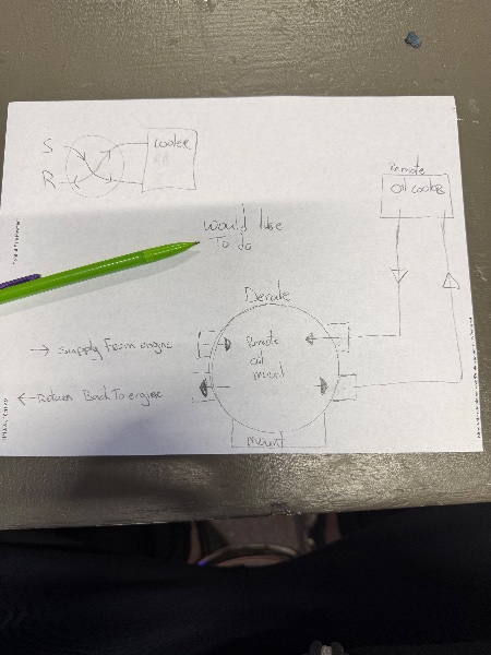

I have a Derale remote oil filter and i’m adding an oil cooler in front of the radiator.
I don’t have the instructions anymore and finding them on the internet is proving to be frustrating…basically i can’t find what i’m looking for.
The first picture is how it’s piped right now. And the second is how I think it should be piped with the addition of the oil cooler. Do I have this right??
There hand drawn, getting a picture of the top of the remote oil filter is to dark.
Try plugging 3 of the four inlets/outlets at a time, and see which one the air comes out. You will need to have an oil filter spun on it. Switch holes and you will find which two are connected as a pair. One of the pairs will allow air through the center oil filter port, and the other pair through the outer oil filter port. Plumb accordingly.
