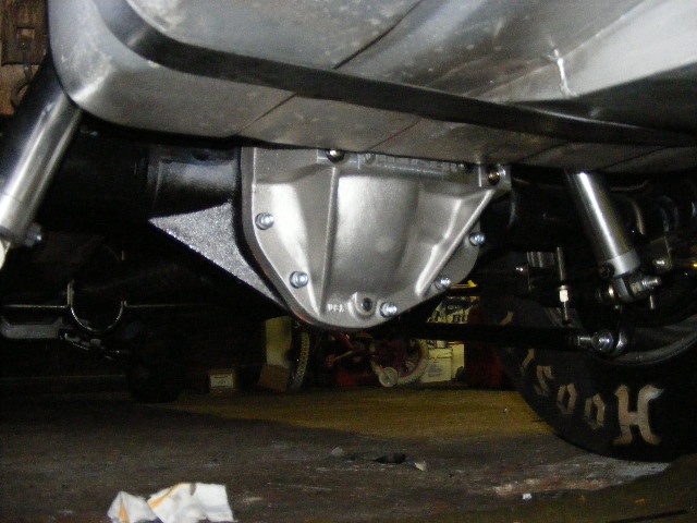

Mancini Racing sells chromemoly driveshafts with the 1350 u-joints(I just bought one for my 904 to Dana app)I also bought just a Dana 60 housing fom Moser and pieced it together.It was cheaper to build it myself.
