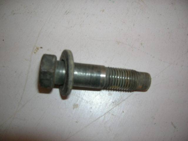

can you buy a long 7/16X20 shoulder bolt and cut the thread portion off so its the right length, ie match the shoulder and trim the threads> Ghetto but might get you out of a jam.
stolen pic for reference....
attachment.php
pishta, thanks it's a good thought. I'm kind of at the "in a pinch" scenario at the moment :)
I'm actually using a small shoulder 7/16 bolt now, but want to get the correct fasteners.
