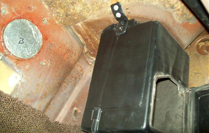

My Dart had been sitting outside for a few years before I got to it. I went ahead and used a 1 1/2 hole saw to cut a hole and used body plugs from the boneyard to seal them. Got them nice and clean. Don't drill too low or you will have to patch a small hole in the metal behind it (yes, I did this on the first one. a little JB weld fixed it just fine). BTW, the Blue Oak leaves around here don't crumble easily, even when dry, so it was the only way to get them out.

yeaterday i spent about an hour cleaning out my cowl. when i pulled the plugs the holes were filled to the tops with leafes and dirt. when i opened the vent doors they were full also. both sides were also loose. when i tried to tighten the bolt that holds the fresh air vents to the cowl the bolt brroke. that was the point where i decided i had enough with these vents. every early a body i have had these have been a problem. so i took them out. this means i wont have a heater also. but its not going to be a daily driver, so its ok. i plan on cutting out the cowl from underneith so i can fix rust. then weld up the fresh air holes and weld the panel back in place.
