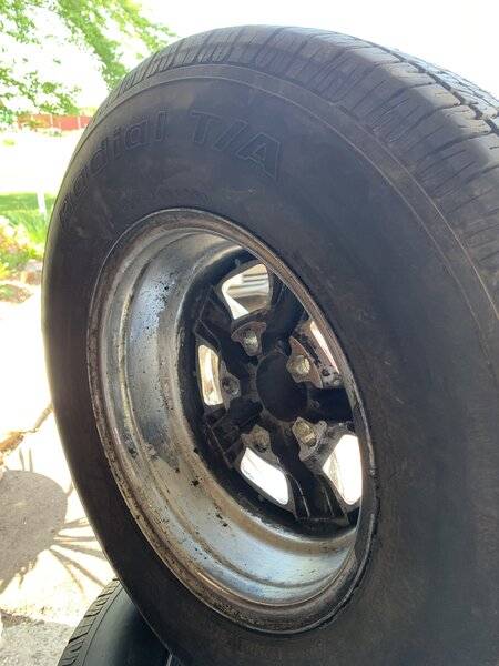

It took a while to find these things and after scouring all usual digital classifieds for months on end. All it took was being re-routed coming back from the cottage one day due to a car accident and some guy had these on his driveway with a For Sale sign on them. The 14 inch rims will work for sure. But I'm not sure if the rubber wall height will fit in the wheel wells. We will see
Have you tried bolting them on? Those look like Unilug wheels and your 64 should have small bolt pattern wheels unless it's been converted.
that 225 70 14 is 0.3" taller than a 235 60 15 which is a common size for our type of car it seems. so only 0.15" closer to the wheel arch height wise. it should be fine. :thumbsup:
