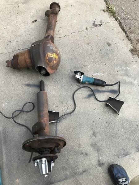

With an angle grinder, plasma cutter and mig welder, anything will fit anywhere.
Right in the dumpster
