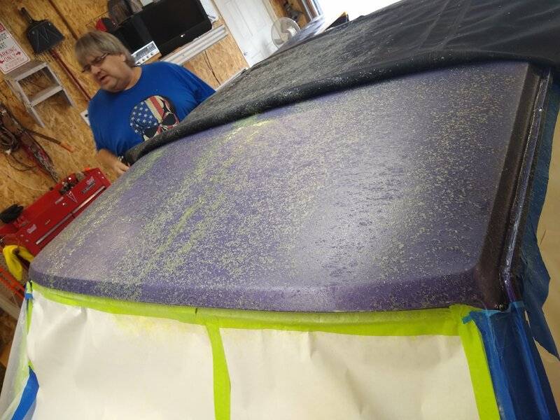

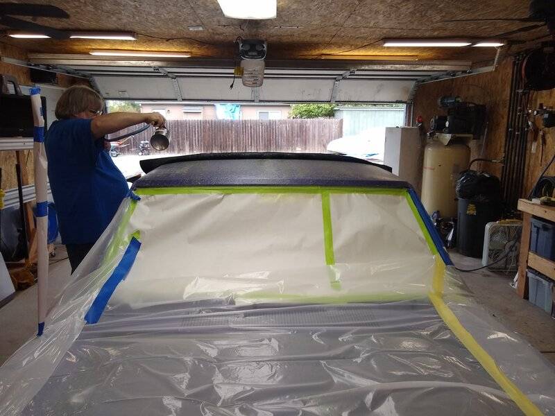

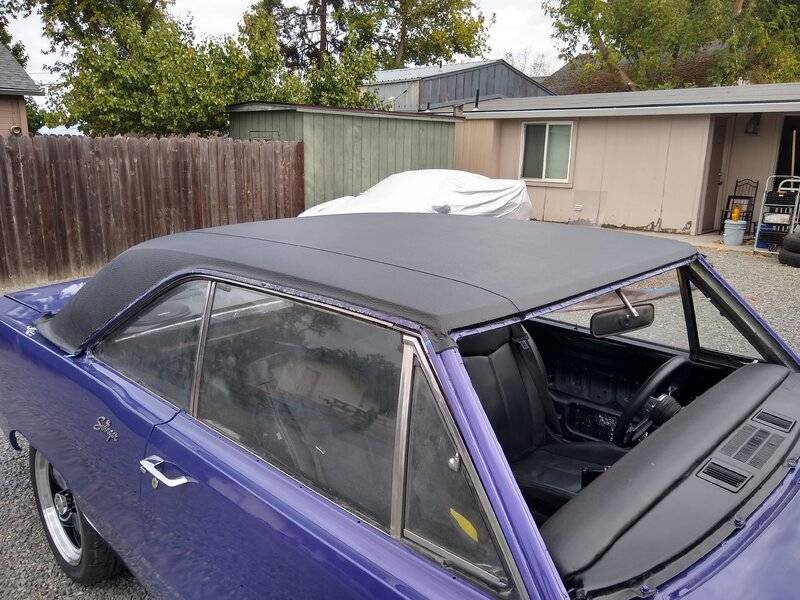

The sail panels was tough, but we got em. Here are some pics I took as we went.
