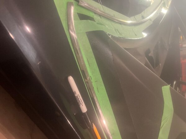

My 69 swinger is a vinyl top car unfortunately when I bought the car, someone had already removed the top and closed up some of the holes due to a repair so I’m about to put the final top back on and I’m having to figure out where the trim around the top goes specifically quarter panels and deck (between the back window and the trunk lid ) I have located and acquired the trim necessary for it however, I don’t have any clips to hold the trim down. Does anybody have pictures of or know where I can get the clips. Much appreciate it as always.
Just google '1967-71 Dodge Dart Vinyl Top Molding Clip Set'. Lots of people sell them. You will have to drill the holes. The clips slide into the trim and have a post on them and a seal. The sheet metal nuts go on from underneath.
