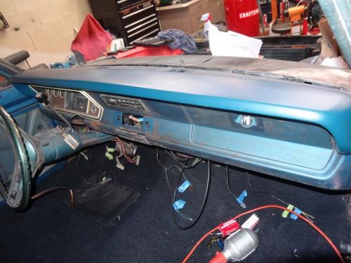

I put two of them on...they just snapped in place...popped it out ...put some glue on it...snapped back in...
Thx- I think I am just going to start cutting, try fit, cut, try fit. Slow like.
You have to ground away the extra plastic around the studs. If not, the dash pad won't seat properly...
before and after...did not grind anything...snap crackel pop.....just add milk....

when I did mine I had the front window out. Mine was off like yours . I used short bungie hooked to cowl to pull pad and a piece of 2x4 inside wedged to push fore ward. If everything works that way take it apart and glue put back together , you have some time before glue sets. I also put weight on top of pad.
